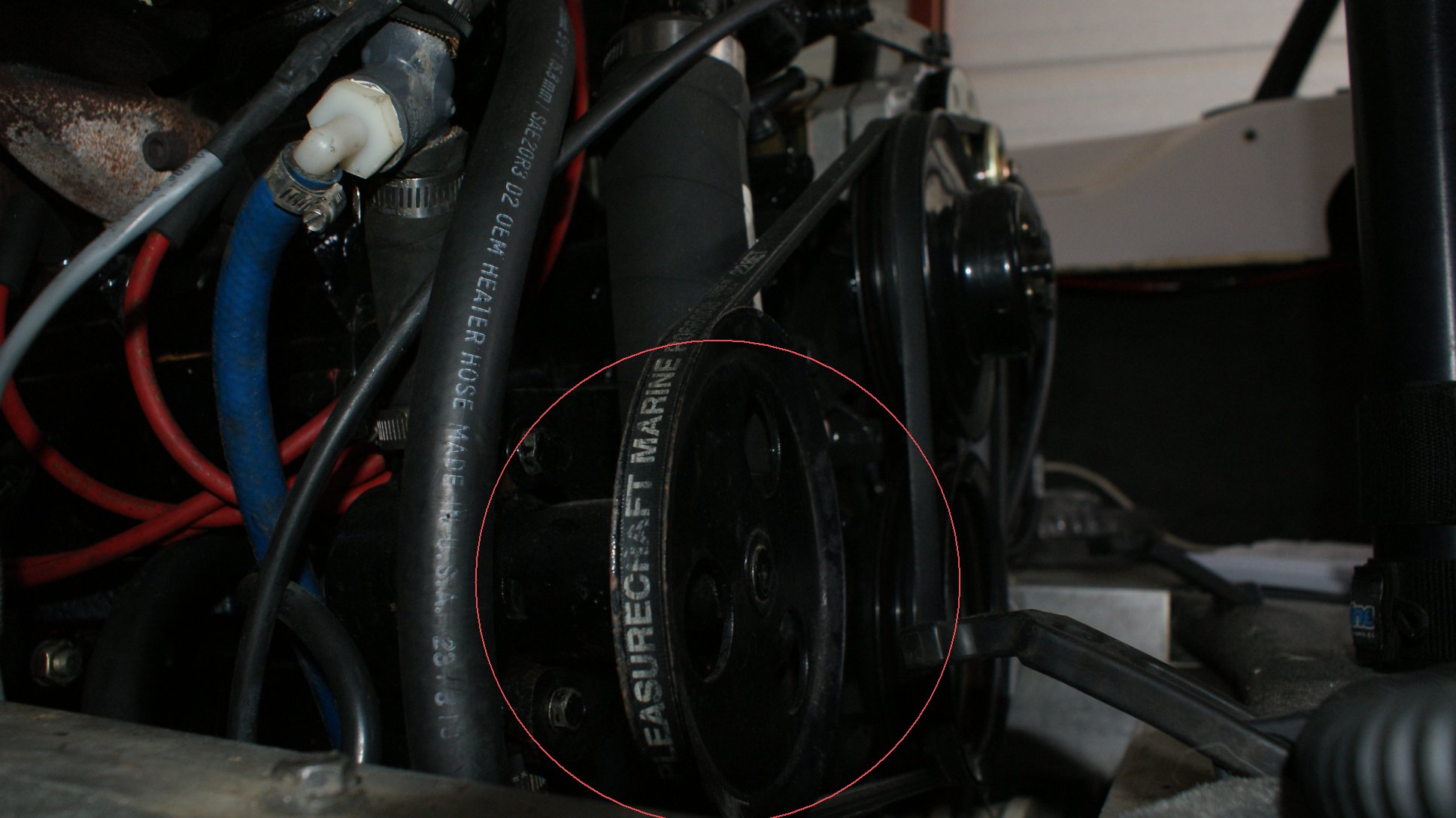

    In my quest to continue learning all there is to know about my Nautique (and to treat it right), I was scoping out the engine yesterday and planning my summerizing project for March. Can anyone confirm that I have correctly located the impeller pump? It seems pretty far away from the raw water intake with it being at the front of the engine, but it is connected to the raw water intake and I guess the front of the engine is where all the belts and pulleys are.

    Yep, that's it. Before you remove the pump, notice whether the large screw head on teh side of the pump is facing toward or away from the engine block. Upon re-installing the pump, orient the screw in the same direction as before pump removal. Otherwise, you will pump water from the engine into the lake....not good!
    Once the pump is on the work bench, three bolts will seperate the pump body and the impellare simply slides off the keyed shaft. You can only assemble the two halfs of the pump one way (bolts are not uniformly spaced).
    When I winterize, I remove the pump, remove the impellar and then place the imellar on a shelf. This helps to prevent the impellar from taking a "set". But, it will be okay to just remove the pump or do nothing (leave in boat) with it when winterizing. Just make sure to at least drain all the water from the proper places.
