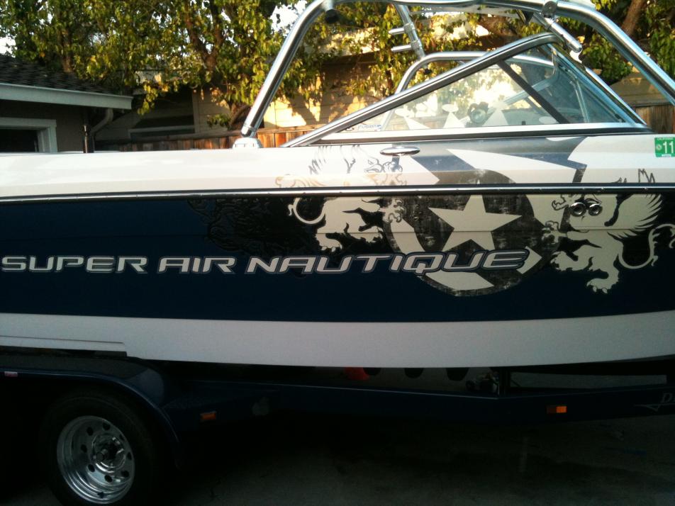

        I am putting my new griffin decals on an 06 SANTE. Lot's of pieces!!! and bubbles!!! can I use water or soapy water and not damage the adhesive?
          We apply dry, but if you use a solution it should only be a couple of drops of soap(Dreft) in a 12 oz sprayer. If you do it dry small bubbles look bad at first but will disapear over time.
          For wet applications spray the boat and the graphic and rub the adhesive after spraying to spred the liquid over the entire decal before applying.

            As a former sign company owner, my advice would be to use what's called the "hinged" method. I would have to write a book to explain this, so it may be easier just too google it for an instruction video. Also, do a wet application, other wise you could have a mess on your hands. Not only does it allow the removal of air bubbles, but if you make a mistake, the graphic can still be lifted from the hull. My "magic" solution was a squirt of lemon fresh joy to 3/4 water in a std size spray bottle. Believe it or not, lemon joy works the best - and I've tried them all! Let the boat sit for 24 hours before taking it on the water or towing it.
                Forgot to ask after you apply the soapy water how long do you let it set before you remove the cover sticker? The clear one? I would assume it needs to dry in order to get the main sticker to stick..... if that makes sense?

                  You can remove the backer just after squeegeeing out most of the liquid. You will need to do this as you will need to squeegee directly on the sticker in some spots.
                  When you peel the sticker, I used to find it best to pull it close to the surface as possible, making so it peels with the least amount of lifting force on the vinyl. The vinyl sticker is very subjective to moving and/or lifting when applying wet.

                    Steve-O is correct. You can remove the transfer tape immediately after sqeeging out all of the liquid, just be careful not to lift the graphic from the hull. Nautique graphics are printed on a high-performance, cast vinyl, so they cooperate pretty well during application. One more thing, make sure the hull is warm when applying, due to vinyl will not adhere in temps under 45 degrees.
                          Done!!
