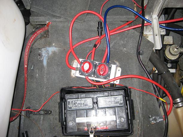

Here is what I have pictures of so far -
-the first is of the original wiring setup
-the second is of the new wiring set-up - please pardon the wiring mess, one of the switches broke and has to be replaced this weekend so I didnt bother making is look clean.
-the last is of the Isolator/Separator wired up - I ended up mounting it underneath the support for the ski pylon. As you can see it allowed very easy access to wire across the boat and should be far enough away from the engine so that I do not have to worry about heat.
