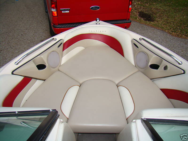

    I am trying to replace the speakers in my 216 and they are set in the large plastic covers and the factory speakers are covered with a cloth mesh. I can't figure out a way to one get the old speakers out and the new ones in without tearing the spaeker covers off. Anyone else gone through this and have a better idea?

    Take those panels out and remove the speakers from the back, which is how they are mounted.

      Not sure if yours is the same but on my 226 I removed the whole speakers pod. I had screws down low probally two, remove them and slide the whole pod up to remove. If its like mine. The covers are held in from the back with 3-4 screws into a nylon ring that is covered with the fabric. I replaced mine with POLKS. I had to use spacers behind the mounting rings of the Polks so they would fit properlly.

        Thanks Jaybird that should help alot! It looks like maybe there is a bracket half way up on the side so I may have to remove the upholstery to get to it. I did see two screws down low on it. I wonder if that is all that is holding them on. I did not get a chance to see if they were bolted on anywhere.

          • 262
          • Huntsville, AL
