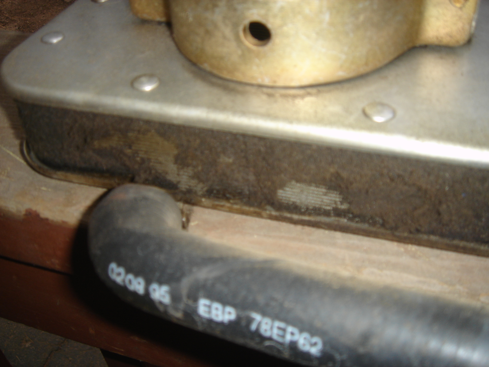

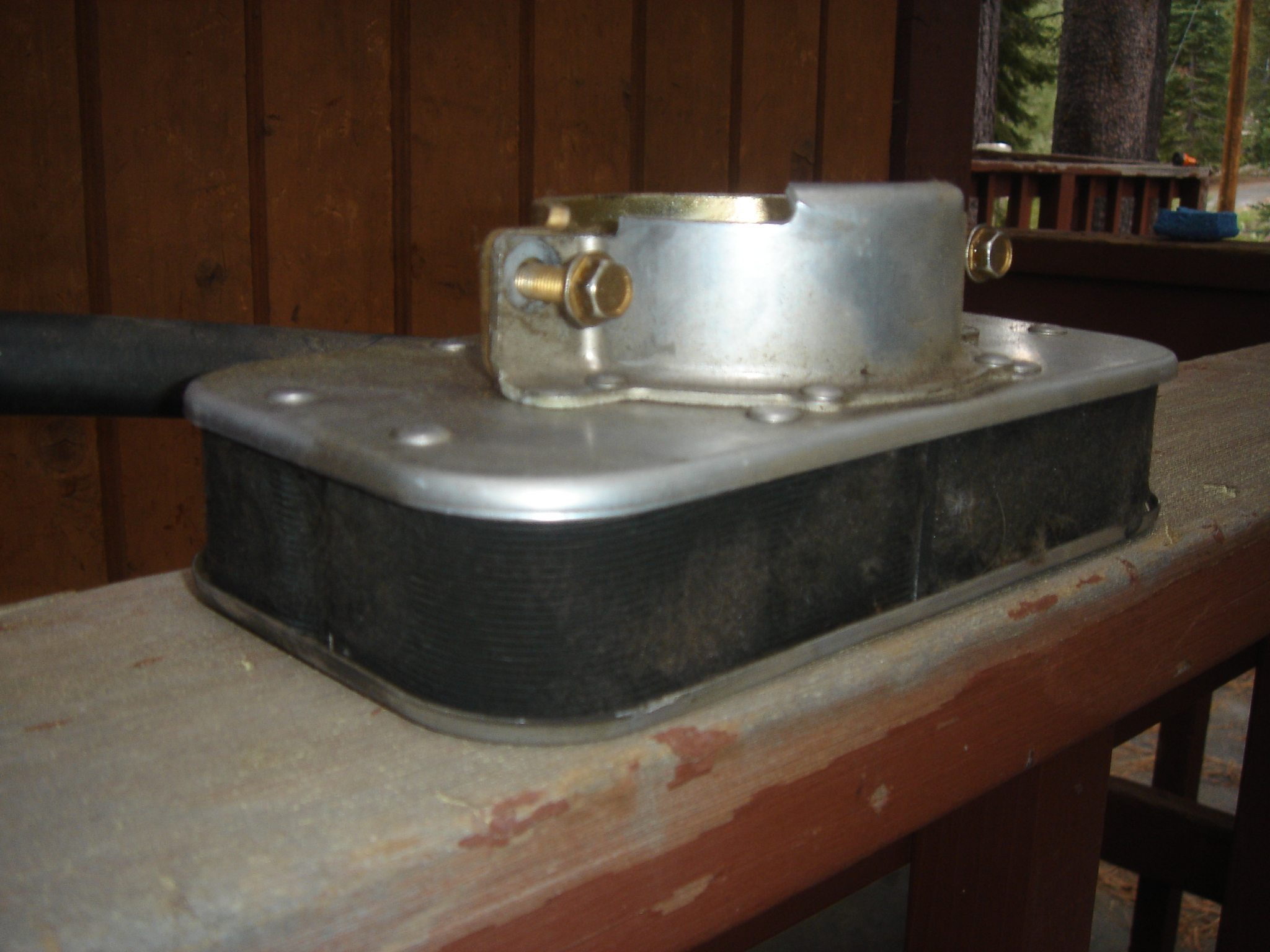

                Nuther development. Just pulled the "cover" off the top of the motor and discovered that the spark arrestor is completely gummed up. I quite honestly can't believe that the boat even runs!!! Do you guys think this can be attributed to the backfiring, poor running, etc? I would think that it would just ALWAYS run poorly.....as opposed to what is happening now, which is that it runs well for about an hour and then goes kaput.

                  It might contribute but I highly doubt that this is the culprit. Clean it and run it. Unfortunately this type of symptom is gonna take some parts swapping to find.

                              Ok, slow down. First get yourself a five gallon gas can and rig up some fuel line from the can to the motor. Try this and see what happens. start at the closest point to the motor and start working your way back until you are back by the tank with your auxilary tank. You want to eliminate all variables. My guess is the whole fuel delivery system needs to be cleaned after looking at that flame arrester. Hope this helps.
