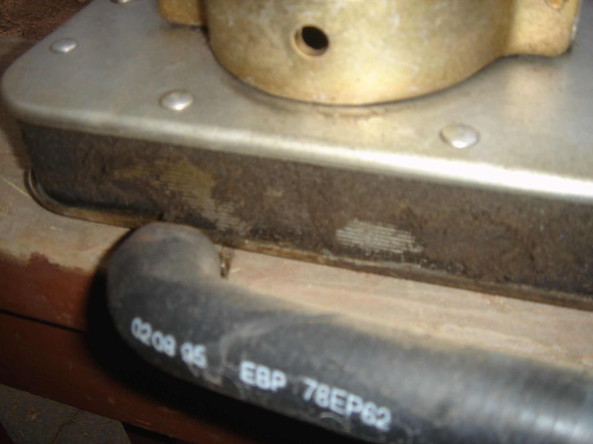

              Just Cleaned the intake and injectors yesterday (Ran sea Foam right into the gas line) let sit for about 5 min. (It obviously mixed with the remaining fuel in the FCC). While appart I was checking the Idle valve. Noticed if I put my finger over the intake to the idle valve it starts to surge. Anyhow, I cleaned the filter on the output side of the idle valve port and it appears to run smooth. It looks like that filter can make or break the idle (and midrange) smoothness. It seems to get mucked up with the valve cover vent that goes into the intake. Why can't that vent go to somewhere outside rather than to the intake? It seems to just clog everything up. Maybe a small air filter in-line with the vent hose to remove all the oil mist that vents out.

                Glad to see that you got your problem fixed. I'm with you on the vent line running up to the filter. Bet yours wasn't nearly as bad as mine was!!!

                  Not even close!! Looks like you had it running in a dust storm!! Try taking off the idle valve and cleaning the filter. I used laquer thinner to clean it out. It is a stainless steel ball of wire that is used as a filter. About 1/2" thick. It just slides into the port but the gasket will have to come off too, the filter is bigger than the hole in the gasket.
