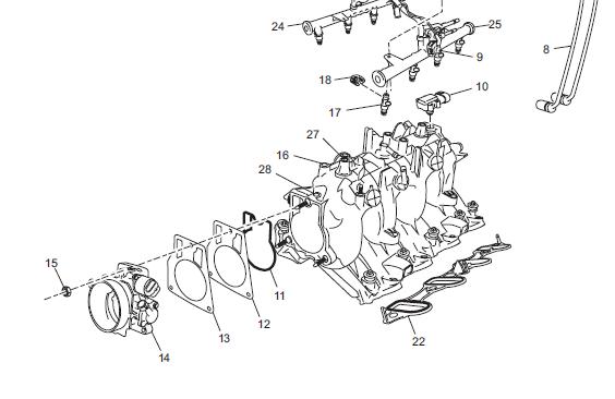

              Re: RE: "Map Sensor See Dealer" ??????
              Originally posted by 03Air210
              Does anyone know where the sensor is?
              Originally posted by AirTool
              Go to the PCM site and download the parts manual. CTRL-F and search for "sensor" or "map" etc.
              Item 10 in the pic PCM part #R020036 Sensor, manifold absolute pressure (MAP)

                RE: Re: RE: "Map Sensor See Dealer" ??????
                Looks like it mounts directly to the plenum [no vacuum hose] I would remove it and make sure the passage
                is clear.
                  CLARIFICATION !!!!!!!!!!!!!!!!!!!!!!!!!!!!!!!!!!!!!!!!!
                  The pic title is 2006 but that is not exactly correct. The pic is from the 2003 to 2005 book but is the same for 2003 through at least 2007.
                  I assume Todd's boat is a 2003 210.
                    Hey guys thanks for the info. I am going to look at it this weekend and see what I find. Changing the sensor will probably be easy but clearing a code is something that will require help(computer). AirTool thanks for the picture and your assumption is correct.
