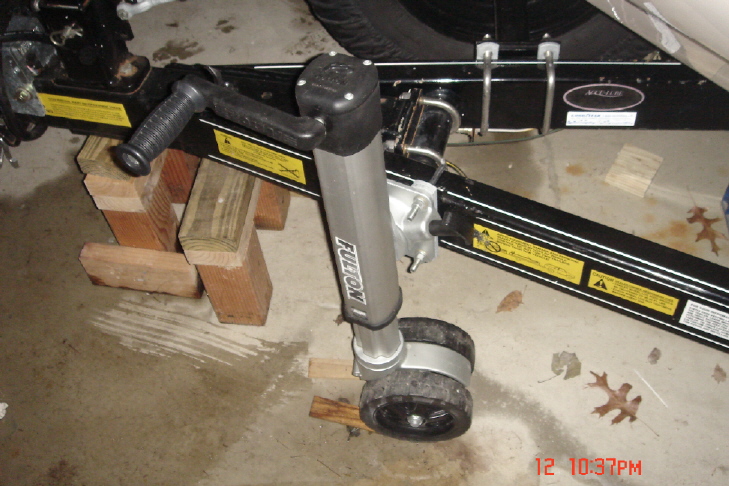

                      I have a 2001 Ramlin trailer that I just replaced the bulldog jack - it was pretty beat up and gave a me a scare recently as I was using an electric car polisher on the boat which was causing some side to side motion when I was working on the bow and that caused the jack to collapse! The jack didn't break, the locking pin popped out due the the way the jack was swaying. I see why the trailer has that triangular flange underneath the actuator, just glad my foot wasn't under there.
                      Anyways, so I just replaced it with the new Fulton F2, which is so much beefier and easier to move around in the garage. I did run into the problem others had with the mounting flange not matching, so I just cut off the mounting flange and used the std U bolts that came with it to mount it in the same spot. I can take a picture of it if that helps...

                        Here is a pic of the Fulton F2 on my ramlin trailer. I had to remove the old mounting plate that only fit the OEM jack.

                          jmo, do you have a problem with the jack raising the trailer high enough? I have an F150 and had to turn my hitch over to lower it enough to use this jack. My boat isn't quite level now when it's hooked to the truck.
                            I don't, and I think the Fulton has a higher "lift" than the previous one. Do you have a raised suspension or something, my tundra just has the stock suspension.

                              nope, stock. Maybe they have different height jacks and I got the wrong one (though I didn't see anything indicating a height). Other than that, I love it.
