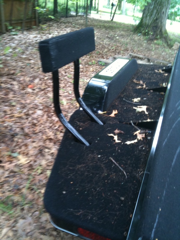

I have a Ramlin trailer for my 2008 230 SAN. The rear guide ons have carpet on them and scuff the gelcoat. Anyone know if these can be swapped out for standard post guide ons from Ramlin or elsewhere?
I believe that setup is bolted to the trailer - correct? If so, you can get a stick of 1 1/4" galvanized rigid conduit and bend it.
You can get an electrical contractor to bend it for you - weld a new plate at the base for attaching to the trailer.
All you need is some PVC pipe and a PVC pipe cap to slide over the GRC.
