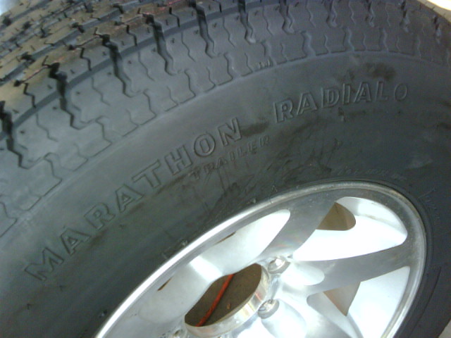

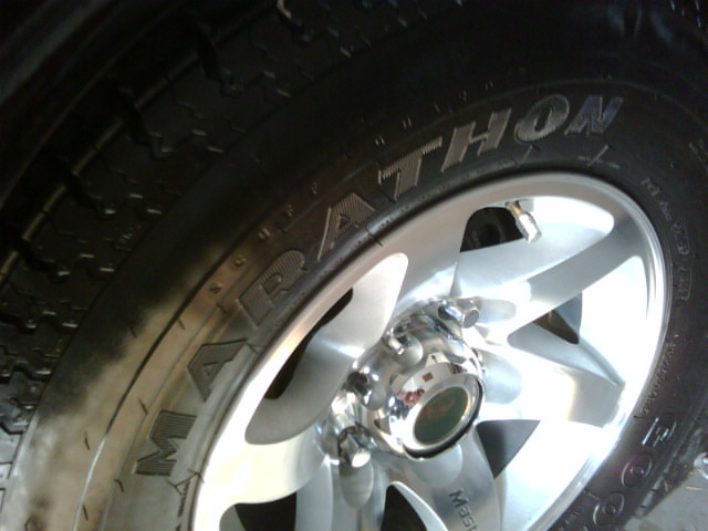

              3 Marathon failures. 2 for sidewall delamination and 1 for belt break. 1 sidewall delam occurred after less than 100 miles towing on the tire. All tires '03 and before.
              After 2 failures in 2008, 2 new '08 China Marathons were put on. They were different in sidewall design. I had my leftover 'good' '03 replaced today with an '09 USA. Sidewall design is identical to '03, not the '08. When my tire place called their Goodyear supplier and asked about the difference, they were told the '08 China version didn't work out well for Goodyear so they discontinued its use/design...which leaves me feeling GREAT about my 2 newer '08 Chinas. :|
              I've got an email into Goodyear and will post what they respond.
              Be on the safe side of your boat/trailer/tire loading weight.
              The '08s look better...IMO.

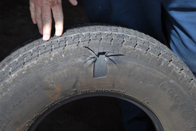

                      RE: Re: RE: single axle trailer tires
                      I dumped my Marathons after 3 failures in 4 seasons, all similar to the failure shown above (mine look like the USA Marathons). The unavoidable potholes on the way to the lake were too much for them. Switched to Greenball Tow Masters last season, not a single issue since.

                              I have had 5 tire failures since purchasing my Ski on a single axle eagle trailer new in '98. 2 original goodyear marathons, 2 Carlisles and a generic that I do not remember the name. All failed the exact same way; bulge in the sidewall. I trailer my boat to the water and put on ~1000 miles a year that includes 1 long haul in the summer of 400miles round trip. Pressure is always checked and within 2-3 psi of the max. 4 of the 5 failures occured during the long haul, and they definately get warm. How hot do your tires get? Can you touch the sidewall when you stop?
