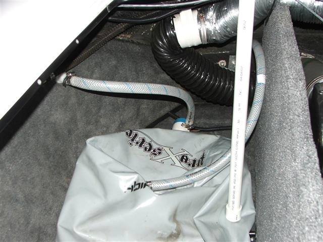

replaced hard tanks with sacs, sacs won't stop draining???

        Just an update on the draining. I turned the through hull fitting and pointed the barbed end up and looped the hose higher and this solved the problem of the water pushing through the pump. If we fill it super full it will still push through a little but not bad. Good to go for now.

          I had areator pumps for emtying and never had a problem. I just put an extra foot of hose which kept the sack from draining.
