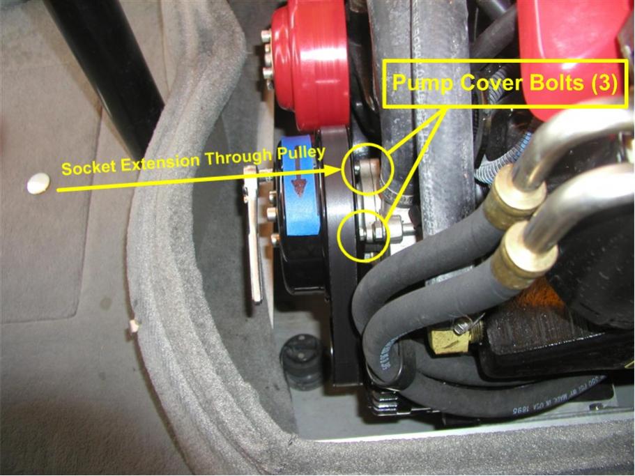

    I hadn't done it in a v-drive, and I'm sure it is tight. The front comes off easily. Find the pic I have posted that shows how the cover bolts are accessed through the pulley. I can't easily find it on the new site.

      You mean this picture?
        That's the one.

                It's much easier to remove just the impeller than the entire pump. You can access the 3 bolts for the front housing through the holes in the drive pulley. These bolts ( I believe they are 5/16") are retained to the housing by o-rings, so you don't have to worry about dropping them into the bilge. Even an impeller switch on a PCM v-drive shouldn't take more than a few minutes.
                  Socket size should be 10 mm.
                  Jaybird - I just don't see how it would be easier to remove the pump. It might be easier to take the pulley off first if you have trouble seeing that bottom cover bolt w/ the pulley on.

                      Not a bg deal.
                      Tools needed:
                      1/4" drive ratchet
                      3" extension
                      10mm socket
                      Take serp belt off, loosen three bolt thru water pump belt pully Note: their are o-rings on the inside of bolt housing so do not completly remove bolts from outer pump.
                      pull entire assy away from pump housing. Note: their are indicators on the top that say TOP!
                      Remove old impeller from housing, install new impeller on shaft of pump re-install into housing in correct allignment , re attach bolts thru pully assy, tighten bolts to about 15ft pounds (hand tight)
                      Re-install serp belt.
                      I have done this procedurs on V-drives in less than 5 min without rempoving entire pump....
