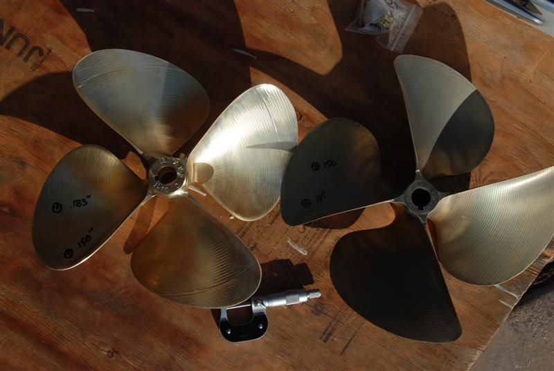

    I had high expectations for this prop. Unfortunately it did not have the holeshot nor the top end of the Acme 644, was closer to the 536 slower top end than the 1160. I found this quite bothersome so I took several measurements. The blades of the OJ where substantially thicker than the Acme. The OJ blades were 0.150 and 0.183" thick near the leading edge and near the center of the blade. The Acme blades were 0.105 and 0.150" thick in the same locations where measurements were taken on the OJ. I can only speculate the Acme either flexes under acceleration or it's thinner profile allow it to perform a tad better than the OJ. It is interesting to note that the OJ should be much less susceptible to damage from light debris in the water, possibly 25-40% stronger than the Acme.

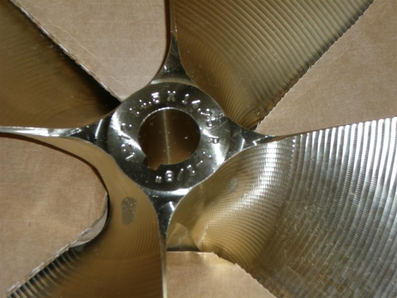

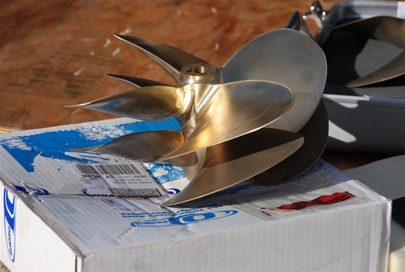

    some pictures of my journey
    Side by side OJ and Acme

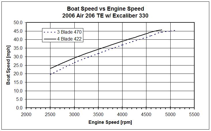

            Here is one. 470 vs 422. Speedo was PP - not gps. I might have text in the original post.

              How different in your experience was the feel of the pull? In my experience its a softer pull with the lower rpm's at ski speeds.
