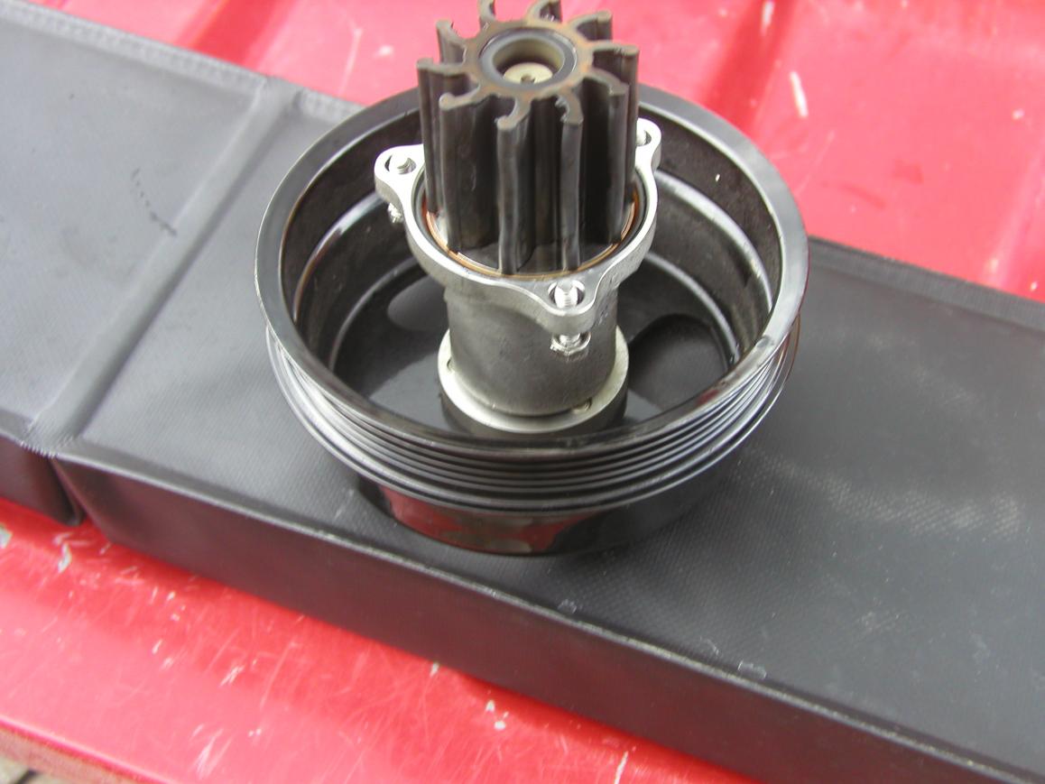

      I'm assuming you have the pump with the serpentine drive belt.
      See pic of o-rings installed. Rub grease on the big o-ring.
      Squirt and lather ivory dish soap on your impeller.
      Assemble carfully.
      Hex size is 10 mm. Be sure the position the cover properly then run the bolts in by hand. Snug carefully then torque.
      Torque on the three bolts is 9 ft-lbs.
      When I go put my impeller back in, I'll finish getting the pics and write that blasted DIY I've promised so many times.
