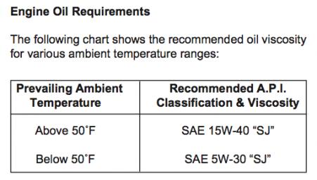

My manual says to run 15w-30 and I can't find it anywhere. I ride on Lake Winnipesaukee in NH and only run b/w June and Sept. Do I need to run 15w-30 or can I run another grade? I'd appreciate any thoughts on this topic. Thanks!

The manual that come with my boat was for a 2005 and my boat is an 03. I called the factory, they are very helpful, for advice and they said 15w-30. If there is no difference, I'll use something else.

They should not have recommended 15W-30. That is not correct. Go by what the manual says.
