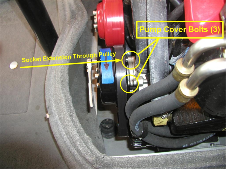

          15mm or adjustable wrench for the idler pully.
          10mm socket with extension for the pump cover bolts. (see pic)

          2. Take the three cover bolts off - bolts stay with cover due to tiny o-rings.

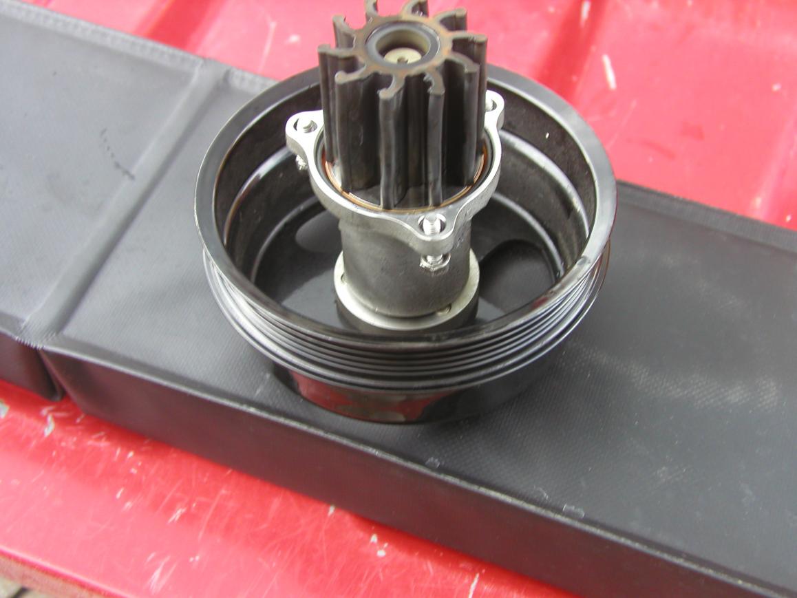

          3. Carefully twist the pulley and slightly mis-align the pump as you pull it out and the impeller will come out with it. Otherwise the impeller stays in the cavity.
          4. Change out the four o-rings. One for the cover, three for the bolts. Some oil or soap as lube is handy but not required.
          5. Squirt some dish soap on the impeller and lather it up with a bit of water.
          6. Place the impeller on the shaft.
          7. Then line up the impeller with casing and "top" at the top. Then rotate the pulley in the running direction and the impeller will slip right in.
