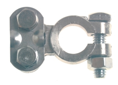

                  They have two clamping bolts to attach to the cable. There is one clamping bolt to tighten the split ring around the post on the battery. The attached image is of universal top post terminal but it is the lead type. The same style is also available in brass. The two bolts on the left hand side are for clamping to the cable. The single bolt on the bottom right tightens the split ring around the battery post.
                  You can attach your 10ga wire from the PME to any of the 3 bolts you choose using a ring lug.
                  Make sure you don't mix up the positive and negative battery cables when you reconnect. You will destroy the PME if you hook them up backward.
