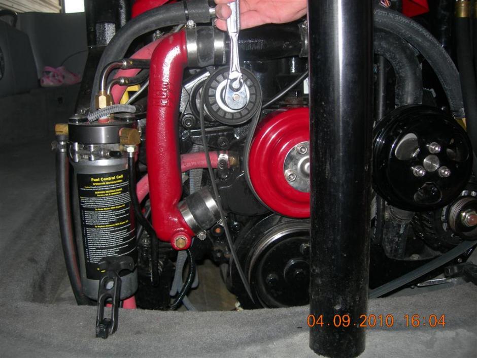

                hey guys i have a 05 210 and need to replace impeller. whats the correct way to loosen and retighten serp belt, just dont want to ruin anything in the process of replacing. pics and instructions would be great! thanks in advance.

                  There is a spring loaded idler pulley somewhere on the engine. I am not a GM, guy, so I cannot be more specific than that.
                  Once you find the spring loaded idler, the serpentine belt is really easy to loosen, or change. You just have to figure out the proper tool, and "trick".
                  Some idlers use a box end wrench, others have a 1/2 square hole you can stick the end of a breaker bar, or a ratchet into.

                    thanks daniel! my mechanic said the idler pulley is on the top left if facing motor from rear of boat. think it is a 5/8 in. bolt. so being that its spring loaded it automatically adjusts belt tension? is there a spec. torque on the 5/8 bolt? the rest of the job i have figured out. thanks again all. thanks in advance.

                        The spring tension in built in the idler pulley. No adjustment needed. just make sure the belt is in all the right grooves, and that is it.
                              This is the proper way and the tension is automatic.
