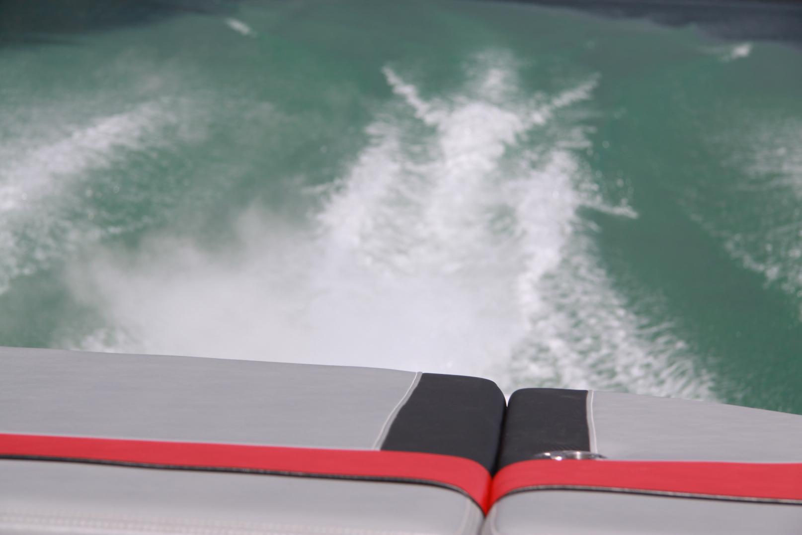

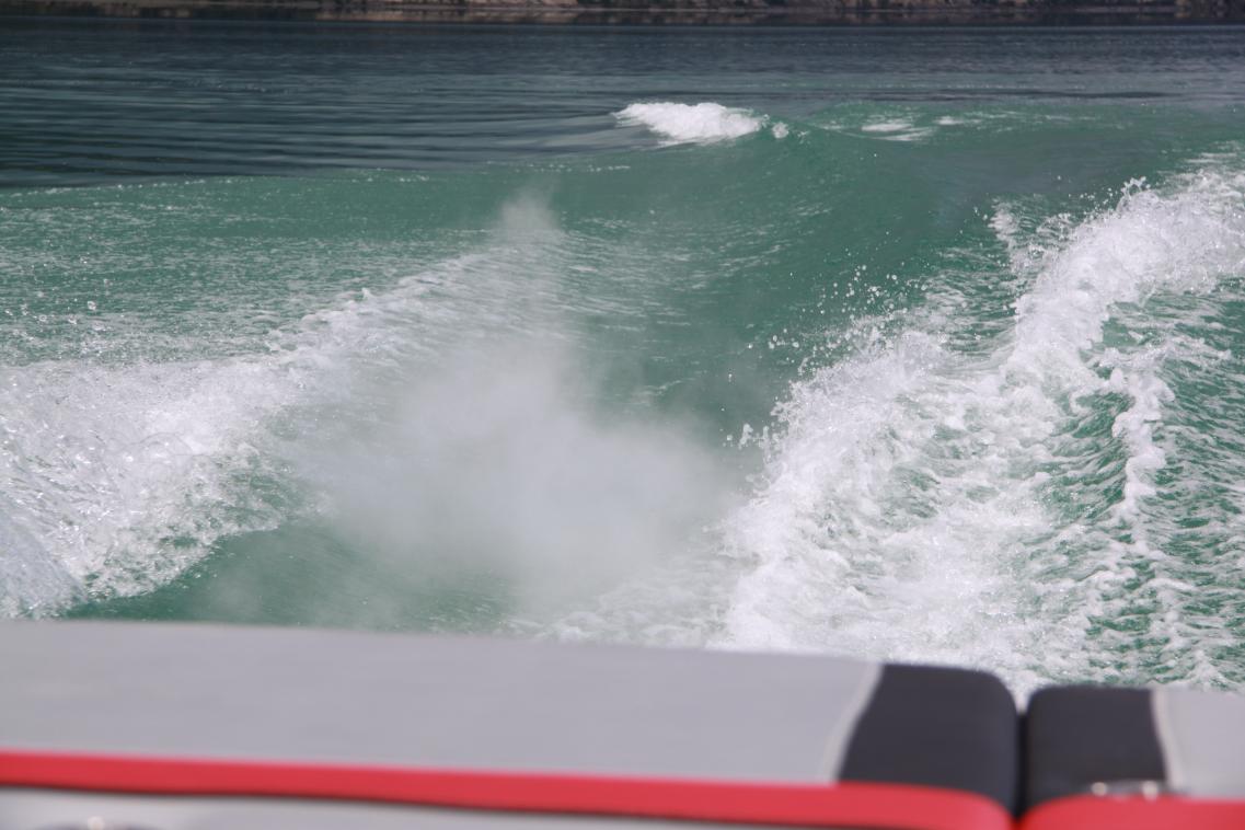

    After doing some searches to find an answer, I still can't figure out if the amount of exhaust smoke or steam from my 210 is normal and just caused by cool ambient temperatures. I think its excessive, but I'm not sure. Once warmed up my boat's temperature is pretty constant at 175. The steam is worse when on a hard acceleration to pull a skier or boarder and then dissipates quickly but is still noticeable at speed. Is this normal or what should I look for to fix it? Hopefully the pics help.

      brananders, can you post the air temp and dew point for the time of day and location you took the pictures?
      There might be a weather station nearby on wunderground.com ....choose wundermap.
      I think that will tell you the answer either way.

          I was hoping the numbers you reported would be closer together than that. I would generally say that 10 degrees spread should prevent any steam. If you were 2 or 3 apart, I'd expect a bunch of steam.
          I'm looking at the pictures and it doesn't look like that much steam to me. Have you put your hand in the water/exhaust stream coming out? Generally at idle, I can hold my hand in mine.
          Also, are the other boats on the lake steaming like that? or are you the only one? (only one steaming that is)
