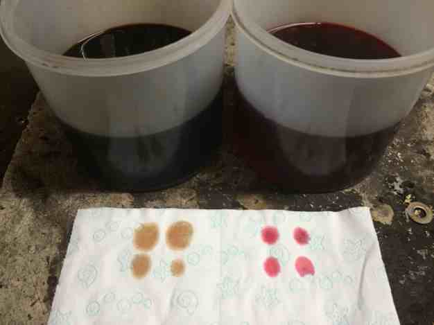

                Sorry for the thread dig but the topic remains the same.
                After owning my boat for one year and about 100 hrs I decided to change the trans oil. I was told it had just had a major service prior to purchasing so assumed trans oil would have been included, my mistake.
                Basically for those who are saying that old oil should not be replaced 100% with new, what would you do here? I'm wondering if it's ever been changed in it's 330hrs.

                  #23
                  I would change 25% every 25 hrs for 4 changes.
