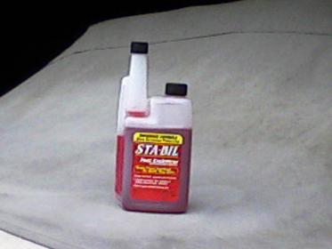

    That is fuel stabilizer, not fogging oil.
    This is the fuel stabilizer I use.
