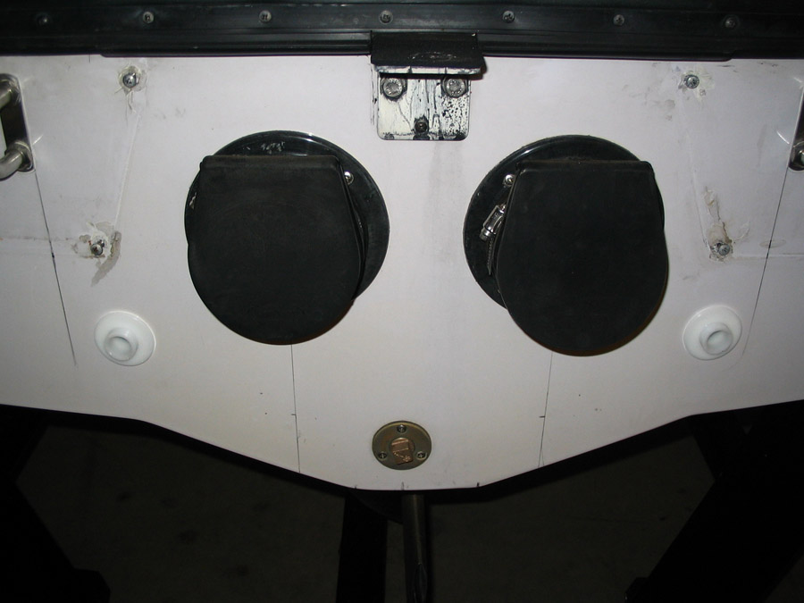

          I see no need for check valves as the pumps take care of that. I chose to not use my stock thru hull. I have separate intakes for each pump that I put under my platform. I have to fill at a stand still but I can drain on the fly. Normally, I will overfill a little bit and shape the wake by draining, if necessary while the rider is riding. Also, separate intakes allow me to fill one and drain the other for switching surf sides. I also agree on just using the sound of the pumps, they are loud enough you are almost always going to hear them finish.

              #21
              Nope, they are under the deck. The attached pic is prior to adding the stainless screen caps.
              the WakeSlayer
              1968 Correct Craft Mustang
              • NautiqueNoob
                • Oct 2010
                • 34
                • Wisconsin
                #22
                Thanks for the clarification. I caught that they were under the Deck (after) I hit reply.
                I would add the mushroom thru hull on the bottom so I could fill/empty while underway.
                Thanks!
