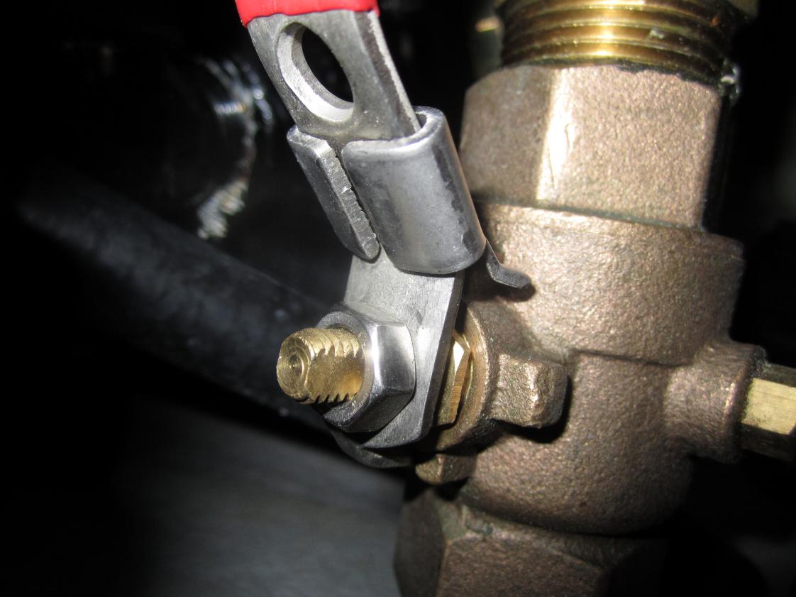

      Airtool,
      This one? I can run by storage in the morning and find out the details on mine if you need

        Originally posted by maxxwell View Post
        Airtool,
        That's the one. Please don't go out or your way in such a hurry. Any time this week would be good. Your picture reminded me I've taken a similar picture...mainly to document the hose size. I'm going to find it and see if the dang nut was there in the pic. I think I would have noticed it missing before now. That also reminds me I'd like to figure a way to make a screened temporary plug for the bilge drain. Anything the rattles loose after a long day is going to work its way to the hole and fall onto the highway. I always seem to be missing screws...and NEVER finding them in the bilge.
        PS - I hope you are enjoying your time off in H town.
        TRDon - I was mainly just wanting to minimize the number of dissimilar materials. Thinking more about it though, I think the lever is zinc plated carbon steel not stainless. I'll check it with a magnet later. It would be best if the nut matched the shaft material.

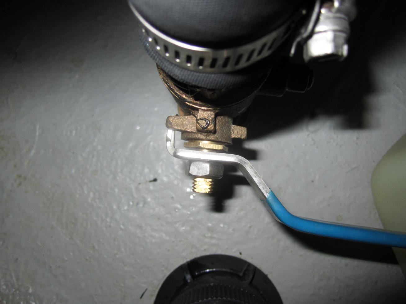

          Airtool,
          It is no problem, My storage is around the corner and I had to run by there to get some measurements for the new sacs. The nut looks like a SS nut, and I looked on the ballast valves also. 1/2" OD but didnt get any thread measurements or ID. It looks like standard SAE coarse thread.
          For your screen... maybe cutting coarse screen material to exact size to be able to thread it all the way to the bottom, so as to clear the plug but seating in the thread? Just an idea

            I checked the valve lever with a strong magnet and there is a small attraction. So the lever is probably a low cost SS with iron in it. I'm sure it is not zinc plated carbon. The shaft looks brass. I'll look for a brass or ss nylok nut so I won't come off again. I think it is 1/4" or 5/16" coarse.
