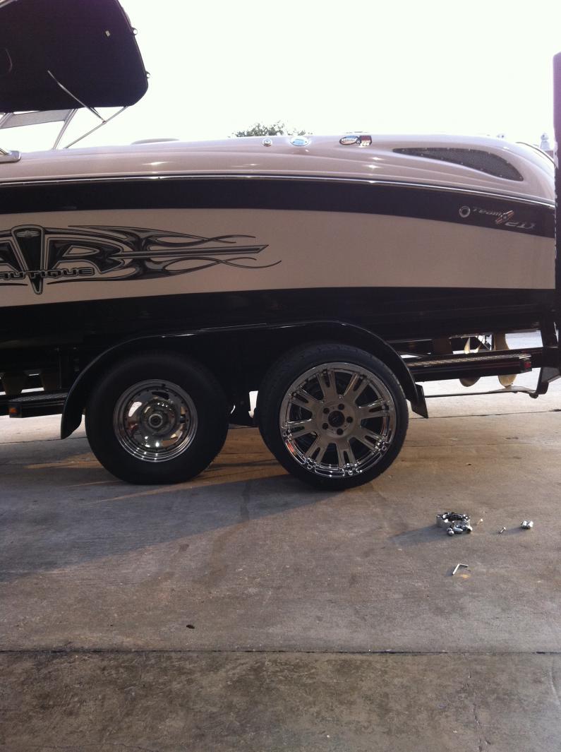

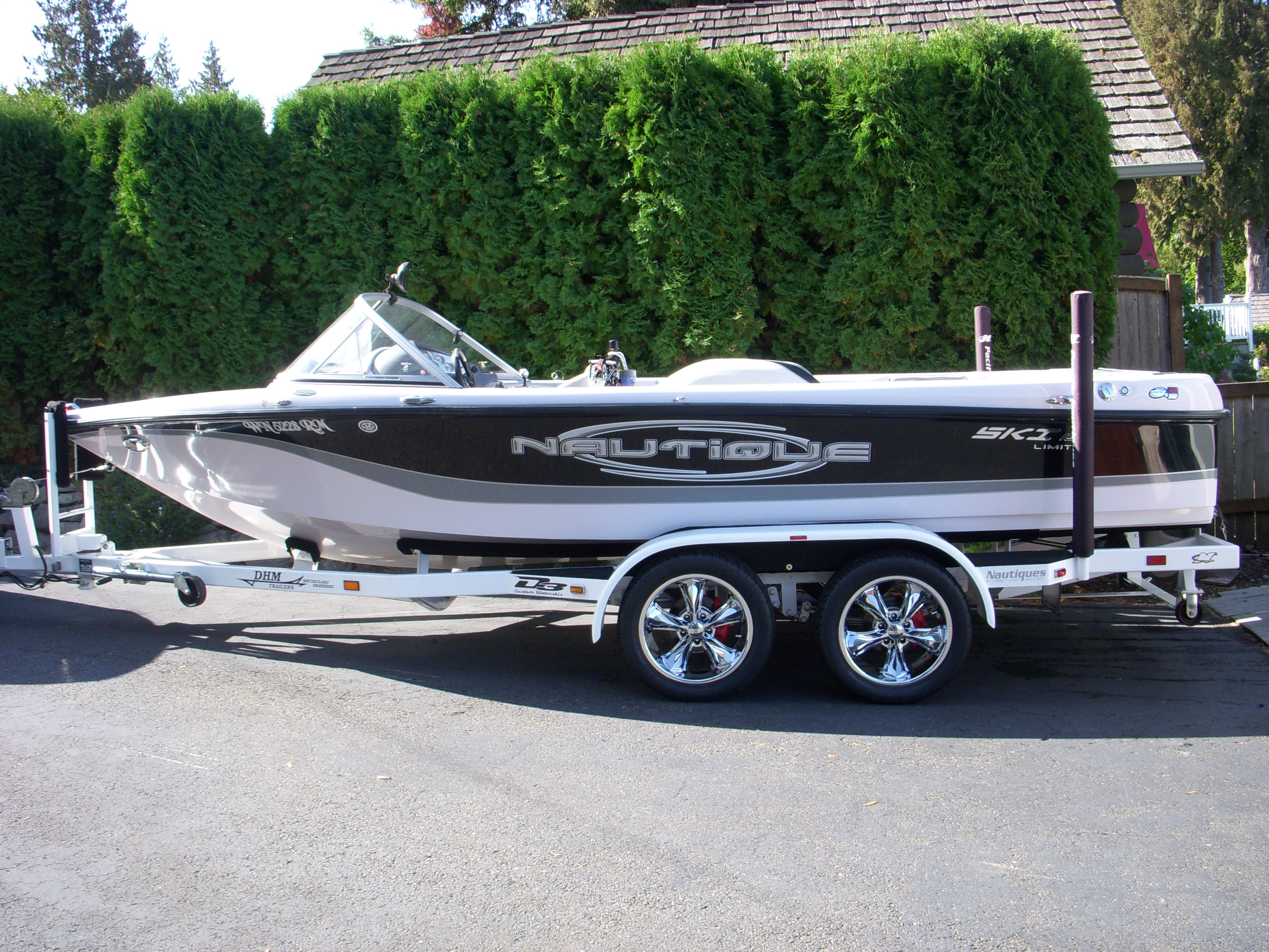

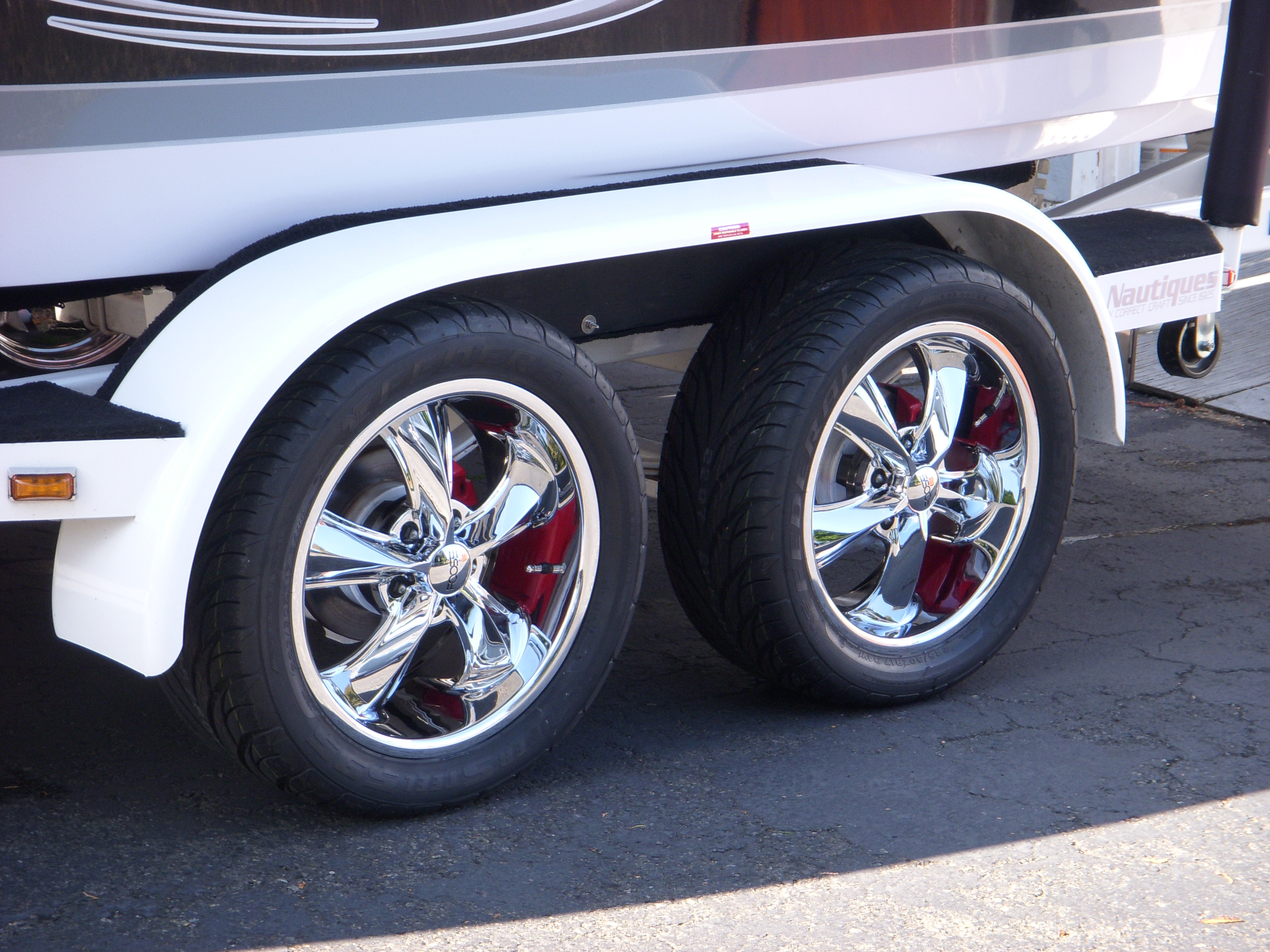

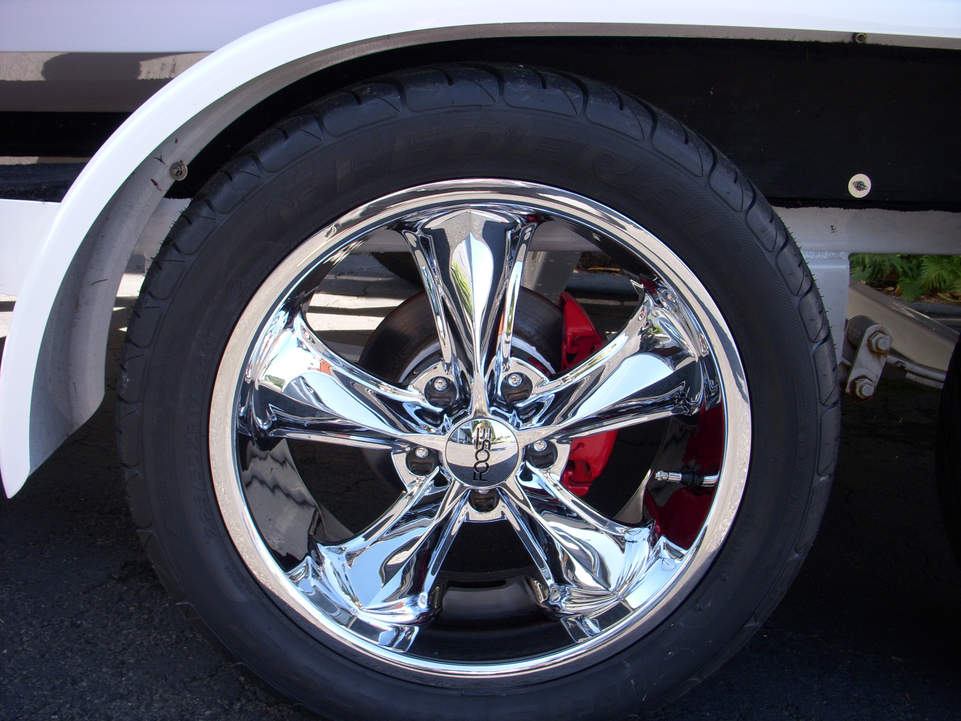

    I finally pulled the trigger after exhausting all information regarding non-ST tires in a trailer carrying my baby. I have researched every aspect of sidewall strength, load limits, types of belting, types of vulcanizing, sidewall thickness, etc etc etc....
    Came to the conclusion that in my circumstance, non-ST tires on 18" rims will be safe.
    I know there are people out there that are totally against this and others say it will be ok. So my research was done thoroughly enough to make the decision. I understand from both sides and agree with both sides, so I am not joining any sides. For me, I decided to do it. Please don't reply telling me that my boat will implode when all the non-ST tires collapse under the load and that the sidewalls will egg out or the rims will shatter.....I understand the risk i am taking, just wanted to show how they look

    Looks real good, I prefer to spend on the boat and the things that go behind it, but it's those kind of things that make your boat your's so don't worry what others think.
    • #3
      That is freakin' HOT!!! Gotta look good going to the lake too!!! What did they set you back, about 2K? Don't new custom trailers come with that type of wheel and tire combo? Great choice in wheels too!

        Those are nice new wheels. Is that a DHM trailer? Would you be willing to sell one of the old wheels? I need a spare. Thanks

          Ski4evr - yeah they were about 1800.. but was a pain to get the right offset and tire width to clear the inner fender, but it cleared without any mods to the trailer

            Rick - Thanks bro, It is an eagle trailer, sorry I am holding on the factory wheels just in case

                  Quinner - the rims are 18x9 with 0 offset 5 on 4.5 lug pattern, tires are nitto nt555 245r18 40
                  there was a slight rubbing on the inside of one of the tires on the wood fender, simple dremel tool took care of that. I took it down bumpy roads and no more rubbing
