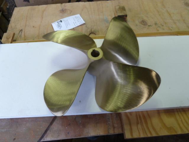

                OJ propellers.
ID:	361779Click image for larger version
                These are two OJ propellers I run on my boat. One has a little more cup than the other. The OJ propeller was OEM on my 1997 Ski Nautique. I bought the second OJ propeller for a spare. In my experience, OJ propellers run a little smoother after the first time they are repaired.

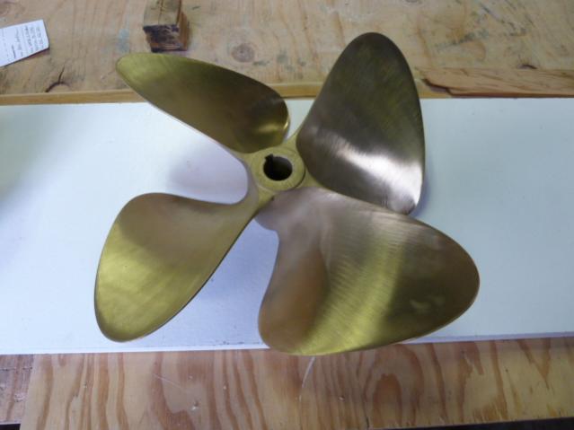

                Acme propeller. (why do i always think of Roadrunner cartoons when I refer to Acme propellers?)
                This is an Acme 422 propeller I also run on my boat, and this propeller is also used on a 1998 Ski Nautique I work on, that is owned by a church.
                On my boat, (1997 Ski Nautique, GT-40 2308 hours) I prefer to use the OJ propeller, when it is in good shape, and is running smooth. I use my boat for show skiing, and the with the OJ propeller, the engine runs a little higher RPM, than with the Acme propeller. The boat will run up to about 5200-5300 RPM, without a load, and the REV limiter starts to kick in. But the boat pulls a little harder off the dock.

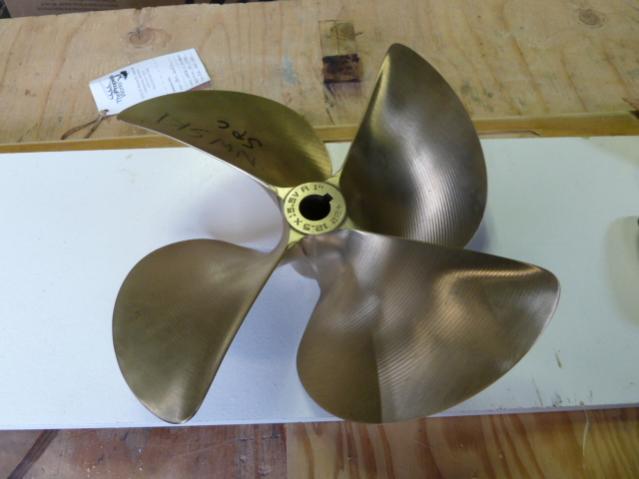

                Federal propellerClick image for larger version
                This propeller was actually on the 1998 Ski Nautique when I first started to take care of the boat. The Acme propeller pictured above is the spare propeller for this boat, but it may end up being the propeller put on the boat when I recommission the 1998 Ski Nautique foir the 2011 season.
