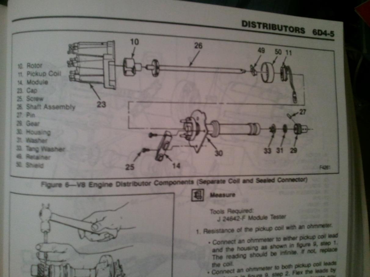

                  I've posted three pics. One pic shows a breakdown of the distributor in case bchesley or others need it. The shield 50 is held down by the retainer 49. 49 only holds it all down. Rotational alignment for the shield and P/U coil is achieved through the use of a roll pin in the stator. The pin is not shown and the stator not labeled because they are not ordinary service parts. The second pic is a V6 distributor i have in my junk pile that shows the pin. If you study the previous pic of the shield, you'll see how the pin aligns in the groove. IIRC, the P/U coil is the same way and (OMG) might even rotate some if you twist it back and forth. Right now, bchesley doesn't know that because he hasn't taken the shield off. The third pic shows assembly text from a genuine GM manual printed by Helm where I quote "Lubricate bottom of the ignition control module and the module rest pad in the housing with silicone grease or an equivalent heat transfer substance."
                  I can't believe I'm having to spend so much time on this but it is only to prevent bchesley from wasting time or being misdirected by people guessing.

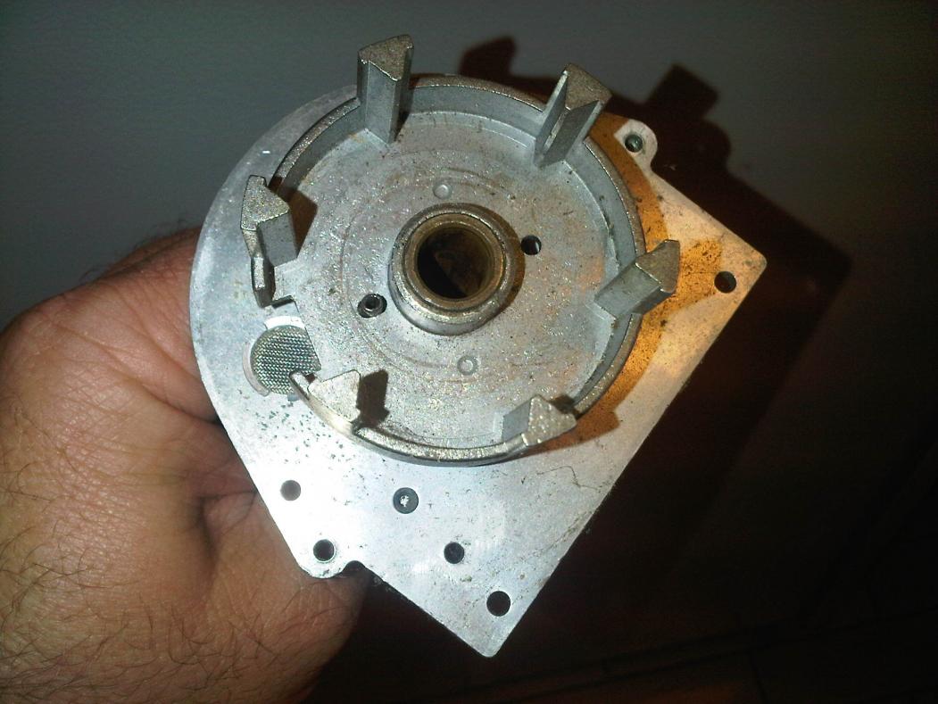

                    your cunfussing two different generations of pick-up assemblies, what you just showed being an older style, the previous picture being the newer style and they do not come apart the same. Nice Chilton's manual though
