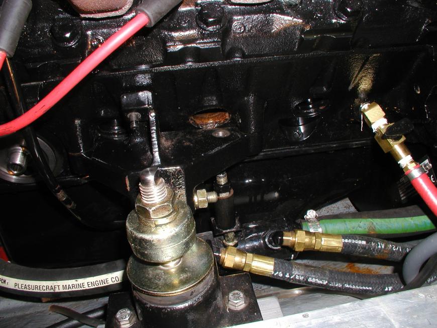

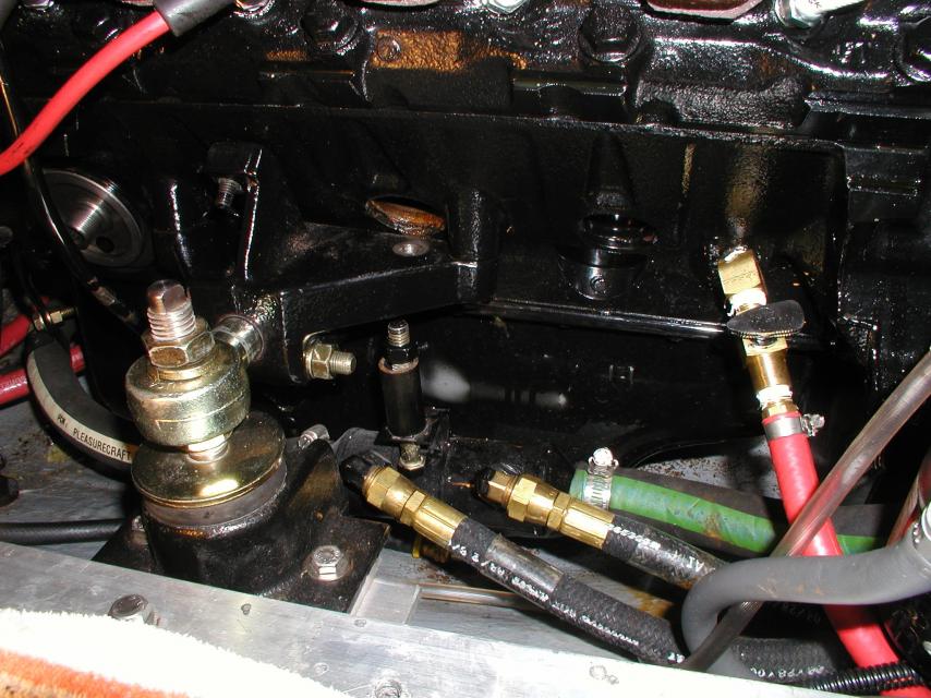

                  frost plug pictures
                  Hi.. Here are a few shots of the frost plug.. One concern I have about raising the engine up at the front is the pressue I would put on the rear motor mounts and the shaft. I realize I would have to loosen off the other front motor mount before I do this. any suggestions?Click image for larger version
Name:	frost plug opening 2.jpg
ID:	361912Click image for larger version
Name:	frost plug opening 1.jpg
                  • IMPACT-EV1
                    • Jan 2011
                    • 86
                    • indy
                    you don't need to loosen any other bolts all you need to do is support the engine at it's present location so once you remove the bolts it doesn't drop down and so the engine stays put at it's present locations. So a small amount of tension needs to be put on the cable supporting the engine block it would have been much easier to use a bottle jack under the exhaust manifold.
                    also make sure you get a brass casting plug.

                      job successful
                      I was able to lift the engiine using the front lifting ring just enough to take the pressure off the motor mount. Then undid the 2 stringer bolts and out came the motor mount. I installed a new casting plug and put everything back together..
