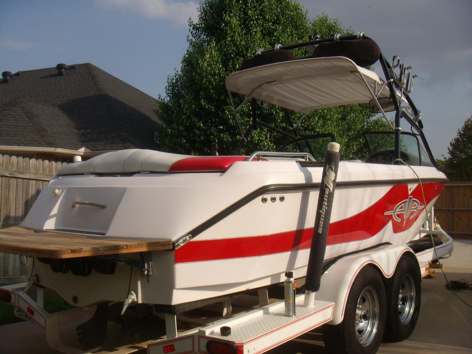

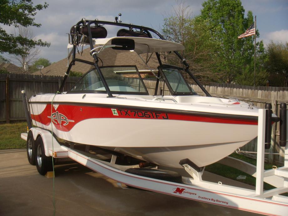

                    Anyone of you want to sell your Python powered Nautique? Or trade for 2003 SANTE 210? Will you at least post pictures please, I am curious what color combos you have?

                      see pics....

                        Jealous. What color combo does the OP have?
