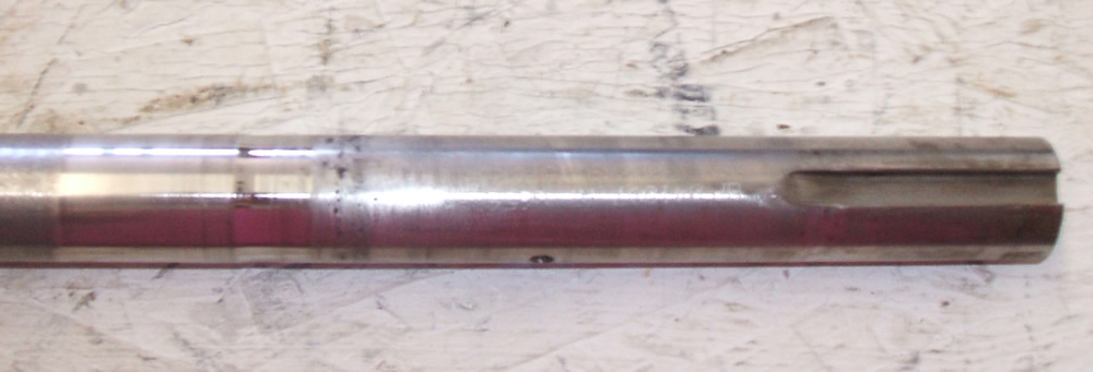

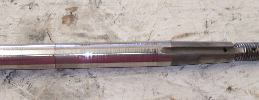

    Thanks to some great postings here, I was able to replace the strut bushings myself on my 97 Ski with GT-40. Used the drive shaft/strut bearing removal tool from Elbert's - worked great! I knew I had to change those bushings as there was considerable side to side movement when grabbing the prop and moving it side to side. I wasn't too sure that I needed to replace the drive shaft, but after I put everything back together and did an alignment, there is still some play in the strut bushings when grabbing the shaft where the prop goes on and moving it side to side.
    My understanding is that there should be no play when the bushings are new, so I'm thinking my drive shaft is worn and needs to be replaced. Is this correct or will there always be a little play? Also, when I was doing the alignment, the coupler didn't line up perfectly with the transmission coupler initially, I had to lift the shaft slightly so the two would line up perfectly. At that point the only thing supporting the shaft was the strut bushings. Not sure if this is normal or not.
    There are some wear marks on the shaft where the bushings rub, as well some wear at the coupler end where the seal would rub. This one you can actually see that the diameter of the shaft has been reduced with the naked eye. The shaft seal was also leaking more than it should, so I also installed a PSS shaft seal since I had everything apart.
    I have not water tested, but the fact there is still play in the strut is a concern. There is less play with the new bushings, but still some nonetheless. I also get a rather loud vibration when I turn the shaft by hand. Not sure what would happen if it was turning fast under operating conditions, but again this is a concern.
    I've attached a couple of pics and would appreciate some feedback on whether you think this drive shaft should be replaced. As far as I know it is the original one, and there is what appears to be a date stamp on the shaft indicating its from 04/10/97, but I don't know for sure that this in fact a date.

    Methinks you need a new shaft. You shouldn't have any play to speak of. The cutlass bearing is a water lubricated device, so if you are spinning it dry, couple with a bad wear groove, that would call the vibration. As far as having to lift the shaft a little to match the couplers up, that is normal. There is nothing holding the fore end of the shaft up. The shaft should be aligned from the strut forward. No More than .002" tolerance with a feeler gauge on the coupler, all the way around.
