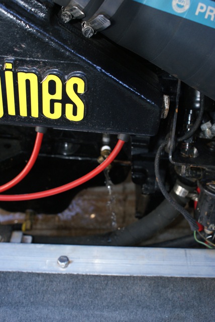

    I had a question on the drain plug location. I have the GT 40 v 8 95 SN. Are they the T bolts on the side with plumber type tape on the threads. It appears there are 1 on the driver side of the motor and 2 on the other.
    Also hoses, which one need to be released to get all the water out of the engine? Lastly, anti freeze goes in the hose once all the plugs and hoses are back in right? How much,.... and will any RV pink type work?

    Two plugs on the back of the exhaust manifolds, one on each manifold.
    Two plugs on engine block, one on each side.
    One plug on the elbow, for the circulating water pump. This elbow is right next to the raw water pump.
    Some of the engine block drain holes may have a heater hose, or a shower connection on them, instead of a plug.

        Got all the drain plugs but the ones on the rear of the manifold. Am I close -see pic above?

          That one has to come out.
