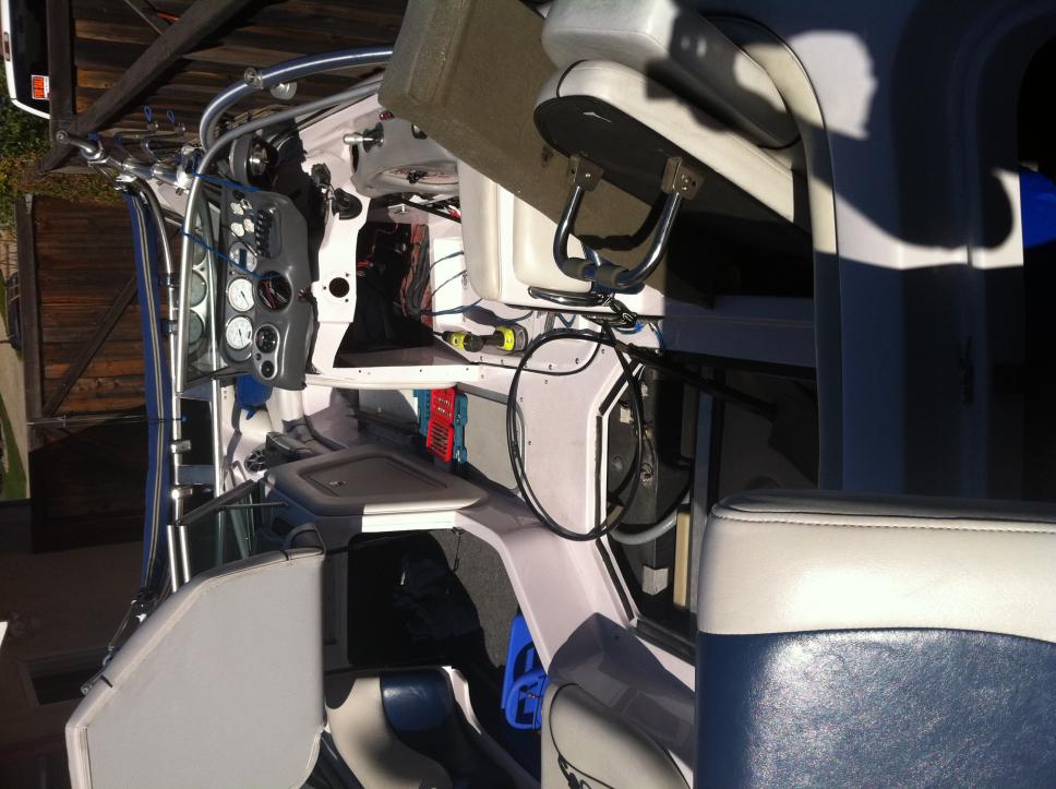

          Here is a picture of mine when I did it, you tell me. I would have happily paid for 4 hours labor if it didn't require major deconstruction of the stereo to get to the cable. As ski4evr said, the standing on the head part to get to the rudder connection is not very fun. Don't remove the ball clamp at the back, just unscrew the cap and slide the cable out. This way you don't need to re-do the alignment.

            Yep, that's what mine looked like!
