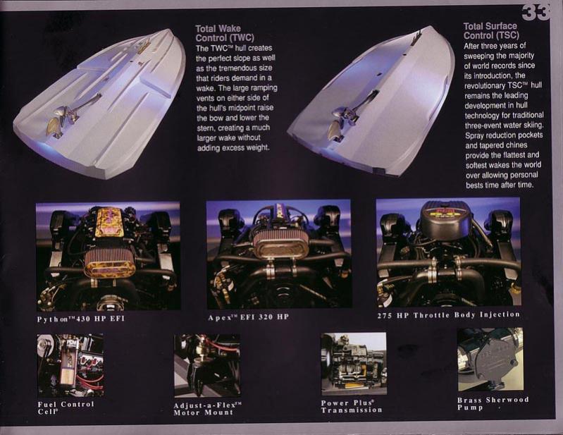

                    That can't be a stock air filter right? Looks to be a K&N and I did not think that they were rated for marine use.
                        Looks Stock to me. Looks like a filter however I would imagine it is a Spark Arrestor.
                        From the 2000 Brochure:

                            Yes that is the apex and they came with the K&N filter from the factory and you can add the remote oil filter system if you wanted.
