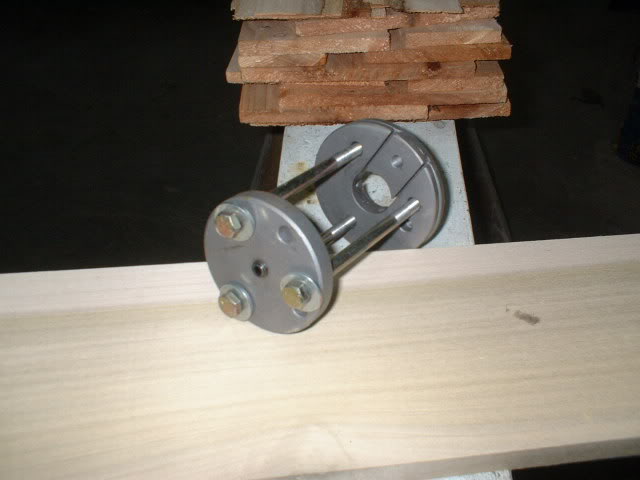

        I've read where guys have rotated the C clamp (well rotated the prop really) to put it between different blades. To kind of work it off a little.Guys on Correctcraftfan have built their own heavy duty ones too. Like this:Click image for larger version

                I have a c-style puller and its not ideal, as it loads up one side more than the other. A 3-bolt or 4-bolt puller like the one shown above will pull much more evenly. That being said, I have yet to encounter a prop that I couldnt remove with the c-style. Install it as tight as you can, and then pop the back side of the puller with a hammer. Hit it once, decently hard, and it should pop. If not, re-tighten and repeat. Let it sit for a while with tension on it and it should work even better. If you use heat, then heat the prop (heat = expansion), not the shaft.
