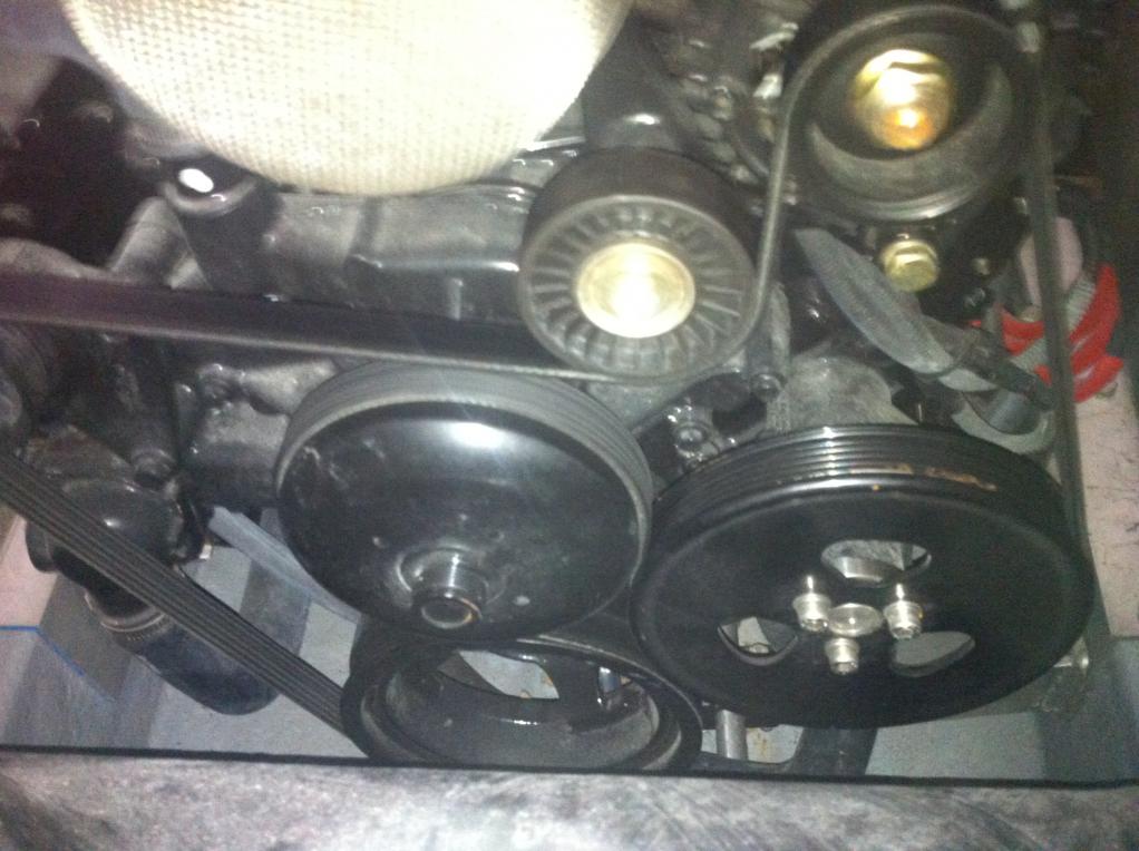

    Where do I release the tension to get the raw water impeller out, first time doing it.

          That pulley is bolted to an arm that is tensioned by a spring. You don't want to loosen the bolt, just loosen the tension on the belt being placed on it by the pulley and the belt will fall off. Make a mental note of the routing of the belt before you remove it.

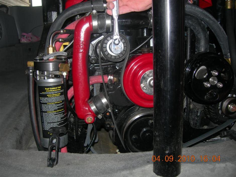

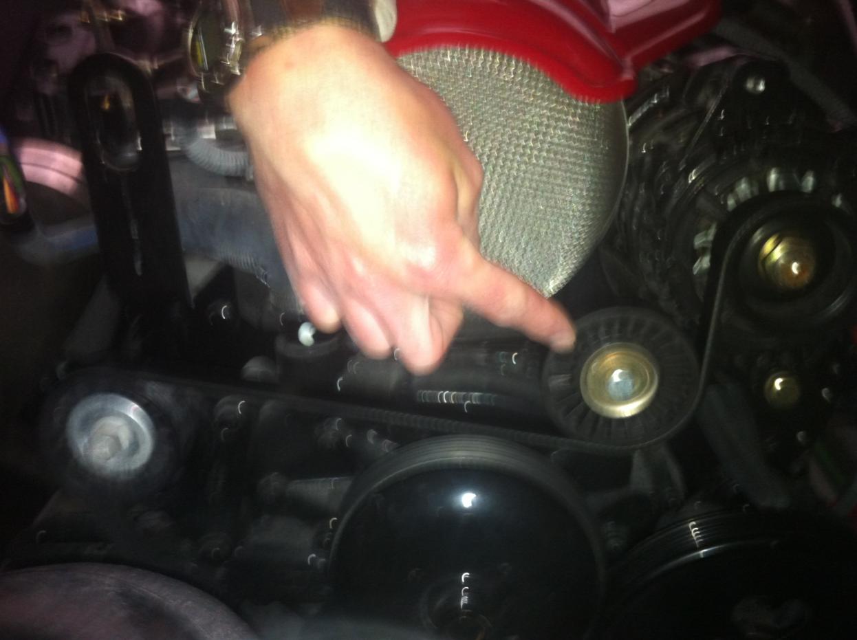

                Its the only pulley with a visible nut on it, take a 5/8 wrench and yes turn it clockwise. it will spring back up with no belt on it, so be careful, Ive smashed a few fingers just letting the wrench go. Do the same to re-install the new belt!
                In the 2nd Picture it will be the top right (port) pulley.
