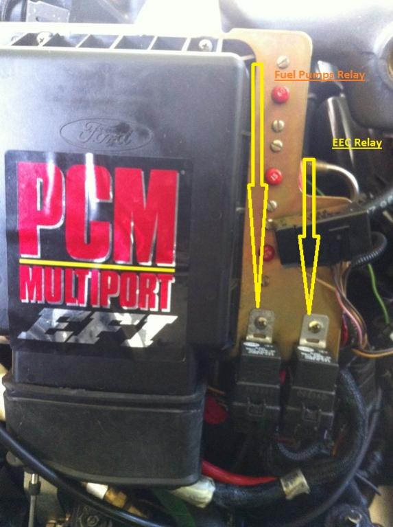

                  I had a similar heat soak problem on my GT40 but it was not tripping the fuel pump circuit like yours. Sounds like it is either a fuel pump or bad (high resistance) connections to the fuel pumps. It may also be worth replacing the fuel pump relay on the computer bracket at rear of engine.

                    Oh yes, if you haven't tried replacing the relay, I would start there (although I would think you dealer would have tried this already). These are known to go bad and cause all sort of havoc. I probably have an extra one, but I won't be down in Austin for at least a few weeks.
