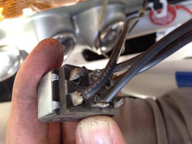

    Ok so I can switch the toggle to the down positon and get the bildge to kick on, but when I flip it up to the ALL ON postion there is no power. I removed the panel with the toggle switch and found what looks to be as if two wires have broken off....is this my problem?

    yep - you are not the first. I'm surprised to see 6 lugs and the wires soldered. Mine was three lugs and ring terminals with screws.

      How do I fix this?? I can't locate the wires inside.

        I can't tell by the pic....to small of resolution. But are you saying the top left lug had a wire and it broke off?
        I get it that you can't find it.

              The lug has broken loose inside the switch housing. Sometimes it will work....sometimes it won't.
              You need a new switch.

                  Its the toggle switch. The one you are selecting "bilge" with.
