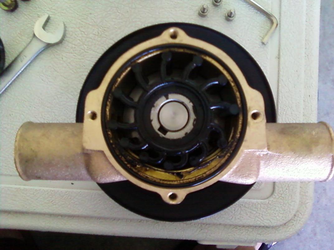

    Hi CC Fans,
    I had posted a thread concerning my over heating problem, however this post is specific to the water impellar. I am going to be removing it this weekend as I think the dealer may have accidentally installed it wrong. When I remove it i want to make sure the blades are in the right direction. Can someone post an image or let me know what way the blades are supposed to be curved with in the housing. I really think this is the problem as no water is feeding up from the impellar.
    Thanks
    if you suspect that the pump isn't priming and/or moving water through the hoses, just wait for the motor to be cold and then start it for a few seconds with the hose removed from the bottom side of the pump. you will know instantly if the pump is doing its thing because water will be shooting down into the bilge. then you can just back flush the hoses to remove any possible obstructions ...
