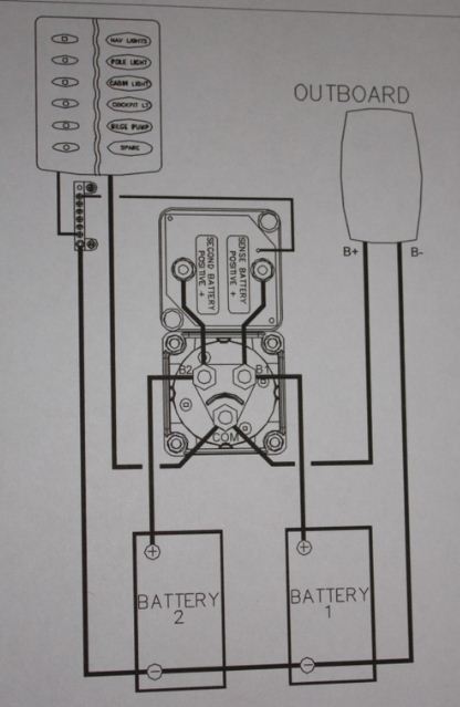

    Hey guys I recently purchased this to help charge my stereo battery I recently added and need help with wiring. The back of the VSR has three terminals, one goes to starter battery, one to stereo battery and the thrid I need help with. Where is the positive & Negative connection points from motor? (GT-40)and what wires do I need to pull and connect to stereo battery so my starting battery is only for starting. Any diagram/pics with would be helpful.

    -remove the existing red (+) wire from your starting battery and put it on the common wire
    -connect starting battery red (+) to B1
    -connect the stereo battery red (+) to B2
    -connect the (-) to the motor grounding point or (-) from B1
    Leave the switch in position 1

      Ok, so I leave the current (-) on B1 and run a wire to connect the (-) to B2 right? Also do I need to run a (+) from the Common to a switch like the diagram?
