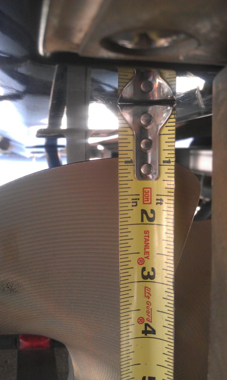

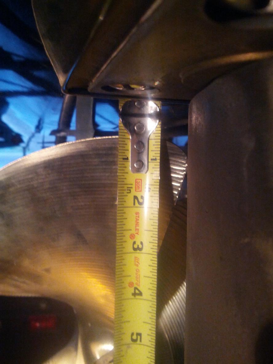

            I am currently running the 1235. It is a really good prop and I get a lot better whole shot with it, especially loaded down. Here is the difference between it and the 1579. I have about 7/16" clearance with the 1235.

                  I don't think you are going to see much performance increase as far as hole shot and such, but lower cruise RPM is for sure. Same principal as turboprop airplanes. More blades = more air/water movement at less RPM. I don't think 14" would be a problem on the 210. The 1235 is 14.5" and that is cutting it a little too close for me.
