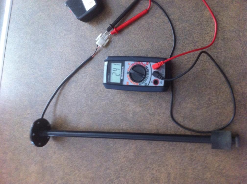

                    The way to check your sender is to take it loose and read the ohms of the sensor. It should read close to 240 ohms empty, and 30 ohms full. If it reads say 150 ohms empty then the sensor is bad. Replace it and your problem should be solved. This is the same issue I'm having with one of my rear ballast tanks.

                      Here are some examples of how to test the senders and what you will see on a DMM...
                        Yes Core Rider your right it is 30 - 240. I was only 100 ohm out! Lol. What's 100 ohm between friends!

                          Test your sender like Core Rider said. Test your guage by touching your signal post on the guage to ground using a piece of wire. If guage ok the needle will move to full.
