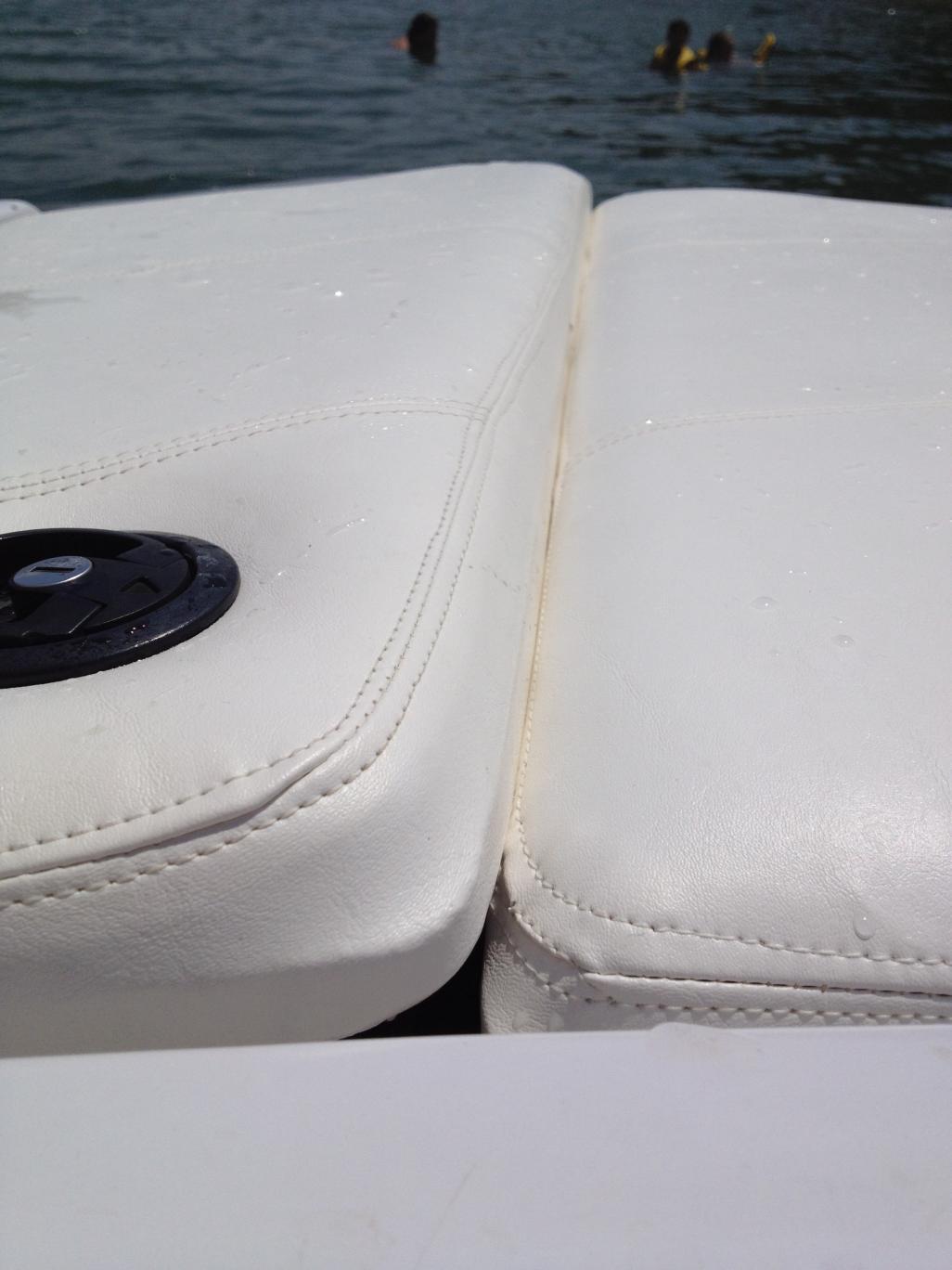

          Here's a picture. I have to push the hatch over to close.

            Is something going on at the hinge side?
            • augustaruss
              • May 2012
              • 10
              • United States
              • 2001 Super Air Nautique
              Both rear hatches do the exact same thing. The hatches were remounted using the original hole locations. The hinges, where they attach to the boat, look undisturbed.

                It looks like the new upholstery might have more foam or might not have the exact stitching or size as the original. You could always take the side hatches off and see if you can slot the holes in the fiberglass or adjust the hinge on the hatch side to make it work. Or take it back the the uphosterer and let them re-work the vinyl.

                  Thanks for the pic. Honestly it looks like the new upholstery job is not quite as tight as it came from the factory which allows the foam to expand more and thus the clearance issues.
