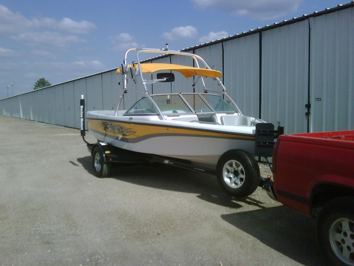

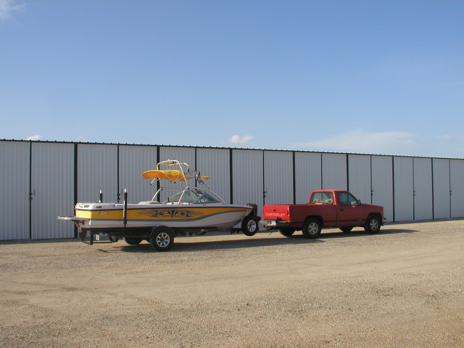

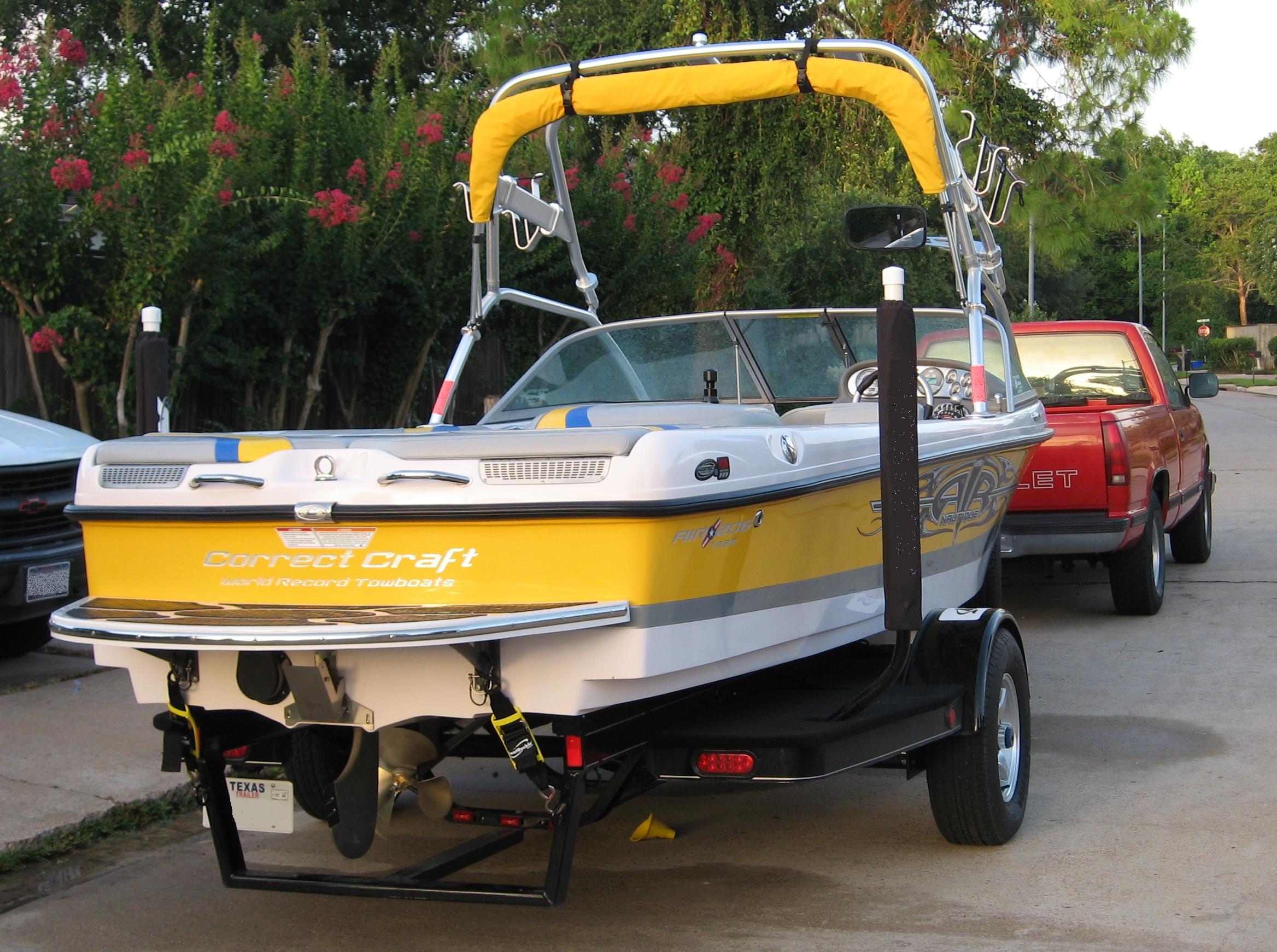

    if you need something more specific, let me know specifically.

      Thanks for the pics. Do you have any trouble with the bow eye getting hung up on the V-block that is between the bunks and the crash pads? Do you need to just put the boat into the water deeper?

              I've never had anything hit except the tracking fins on the extra sub-bunks. These sit below the wishbone and don't tough the boat.
              I felt they were a pita a maybe for a 216 but Ramlin tells me they were put there to kee the boat from going to far left or right and hitting the wishbone.
              I'll agree with gator that sometimes deeper isn't better especially depending on ramp slope. Maybe dip it in deep to wet the bunks then pull it back out some.
              That v-block is adjustable. do you have it all the way down?
