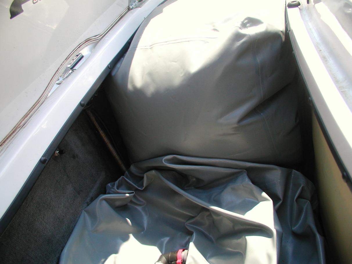

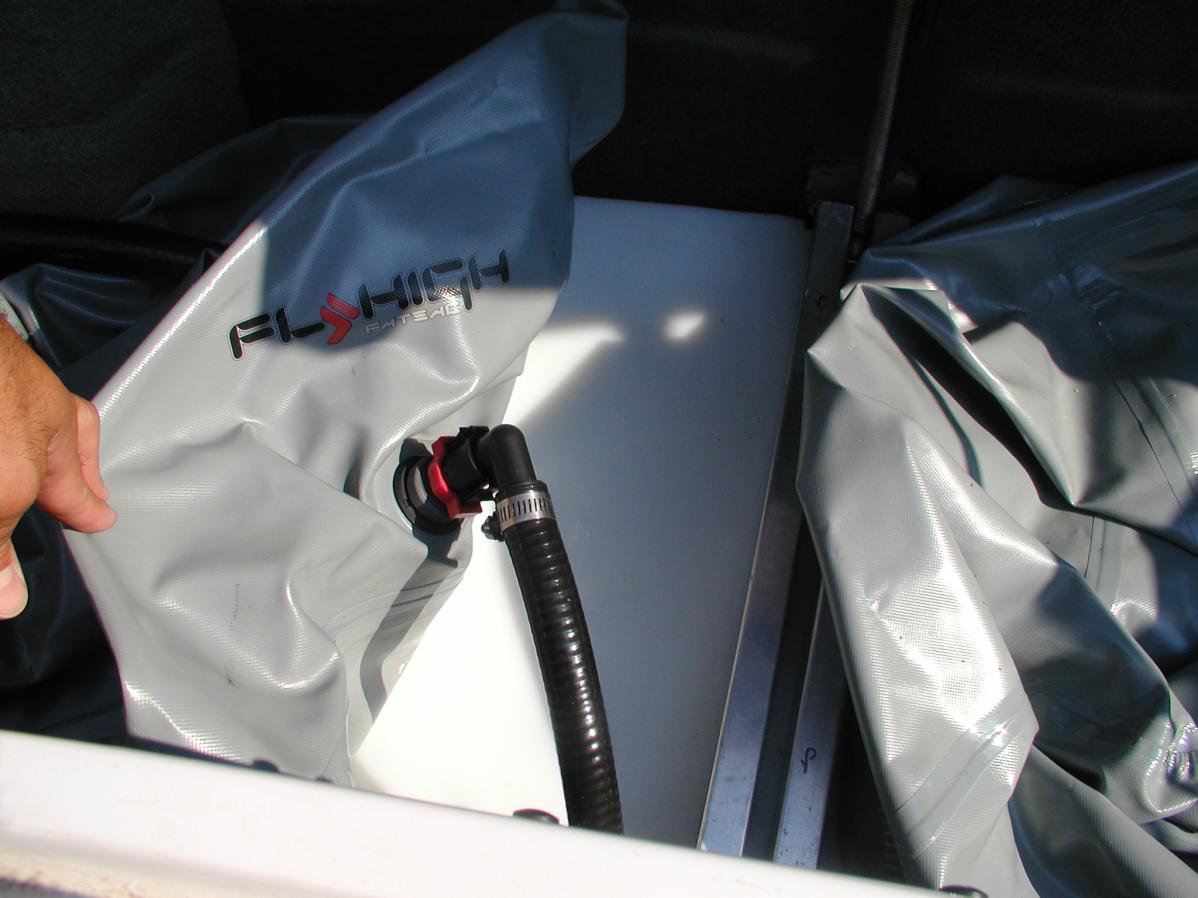

        Rbalan was trying to get you to search the site, alot of info here, and also on Wakeworld.
        I'll link the thread from my build on my old DD boat...
        http://www.planetnautique.com/vb3/sh...hlight=ballast

                You can definitely get a good wake out of this boat, depending on how much weight you put in it. Based on the install I just completed, I would recommend the v-drive sacks in the trunk and a tube sack in the belly. I used the gravity games sacks in the trunk and the rear seat sack in the locker, but they're all a bit too big for the space, particularly the rear seat sack in the locker and don't think it's worth the extra money. I would also recommend adding additional weight in the back on top of that and currently am running a 750 on the rear seat, but I need to take the seat back out so it fits. If you add the sack on the rear seat, you'll likely want some extra weight in the bow, but you surprisingly don't need too much and I am currently running without it. You will likely want to prop up though, particularly if you're making tight turns often.
