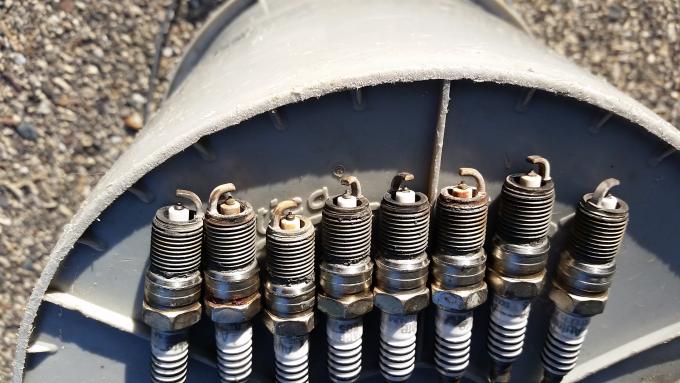

              It is three years later. Thought someone might like to see what about 330 hours looks like on a set of plugs. I thought they looked pretty good. I haven't tested yet. With the hard tanks replaced with 1,100 sacs this is a 30 minute - or less - job. After putting anti-seize on all eight, I just sit down on the sacs and take them one at a time so as not spend any time figuring out which wire goes where.
              P.S. I would also add that after over 330 perfect hours we have proved conclusively you don't have to pay more for a set of plugs for the 343. Just go with the autolite app605 double platinum plugs and be happy.
