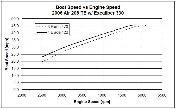

        the factory 3 blade is 470. There might be two other choices but you have to study the table at the acme site.

          There was never a "factory 3-blade" option on the 196.
          The 470 will turn 200rpm or so higher than the 422, as it has 1/2" less pitch. My dad ran a 470 with extra cup in it on his '03 196/Excal... but honestly, Id just stick with the 422, as it will keep your WOT revs right about where you want them (~5000).
