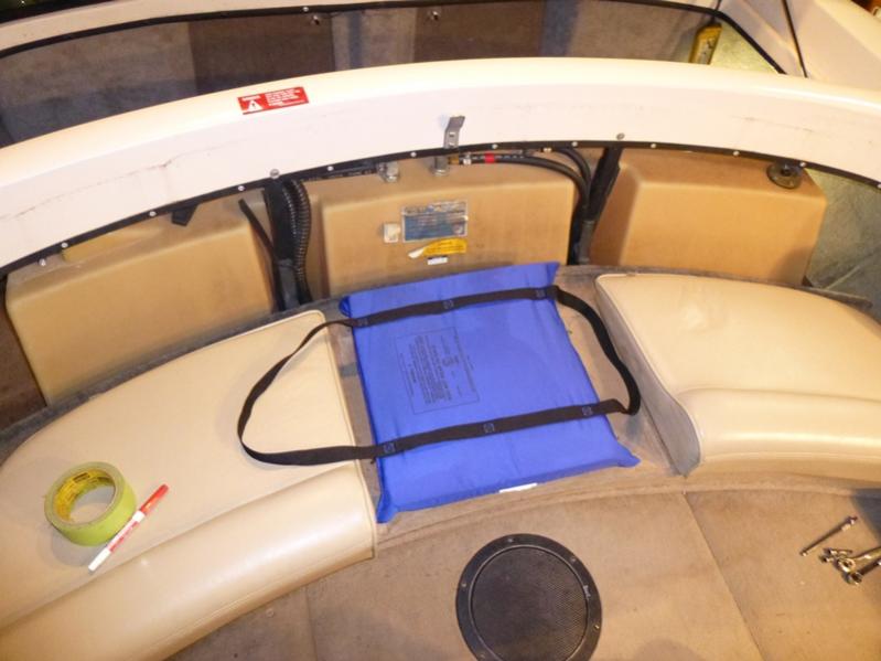

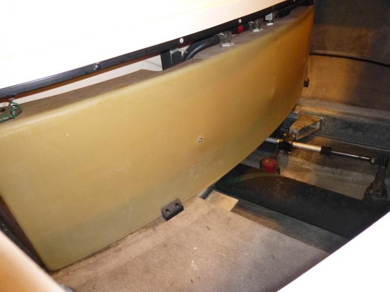

              Okay, got at it tonight and it was easier than expected - key was I did not have to pull any lines or hoses. So, pulled all the panels out of the trunk and unscrewed the two small stops. The next trick was to figure out how to get the seat out, thought I had to unscrew it from the inside, and then figured out it popped straight up. Found the pins for the seat bottom, and pulled the seat bottom out. Then saw two big brackets that held the tank in place and it looked like I would have to unscrew them from the "crawl space" under the floor. Looked closer and figured out I could turn them 90 degrees which allowed me to slide the tank enought to get full access to the sensor. Pulled the sensor and saw lots of rust and the float was stiff. I believe the rust is due to the fact that the boat only has about 175 hours on it, 115 when I bought it last spring. So the boat sat a lot and am guessin it had a partially full tank and it rust in the headspace. It actually worked when I moved it by hand, but going to order a new one anyway. Suggestions on where to order it?
