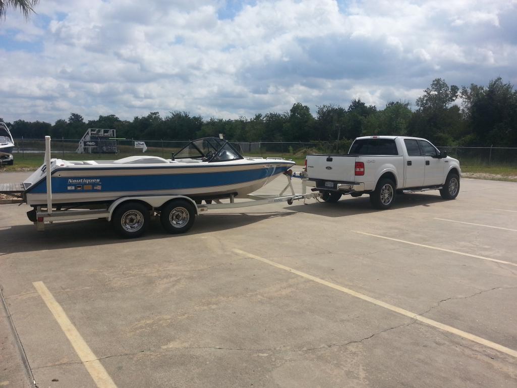

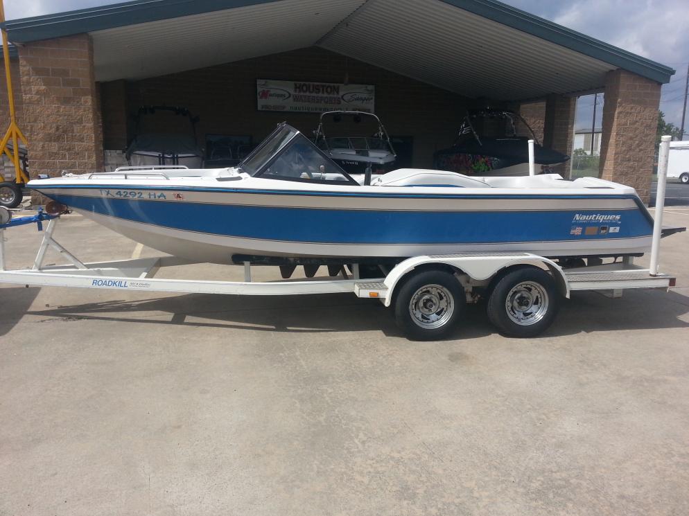

    Here are some pics that I took the day I dropped it off at the service center.Click image for larger version
ID:	365637Click image for larger version
ID:	365639Click image for larger version

          BTW, tsassman...gorgeous boat. And great thread...evidence this forum is tremendously valuable.
