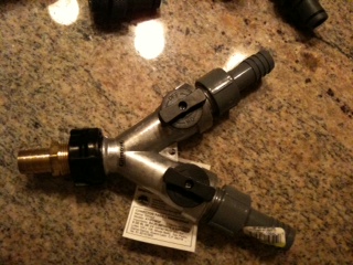

ID:	365283 You can do it with cheap parts. I think I got this garden hose splitter from Home Depot... it was there or Lowes. It has larger than normal diameter pipe, so it does not cut down much if at all on flow. It has worked great for my surf setup and allows me to use 2 bags off 1 pump. I actually have it set up so I can fill 5 different bags with 3 pumps, but only 4 bags can be hooked up at a time. I don't need my off-surf side bag filled when surfing, so I designed a quick connect setup that allows me to disconnect the off-side rear bag and hook up the Y splitter instead to lines that run to the bow and the main cabin area (can use the same lines for surfing either side). It works great.
    I had to add the hose barb fittings of course.
