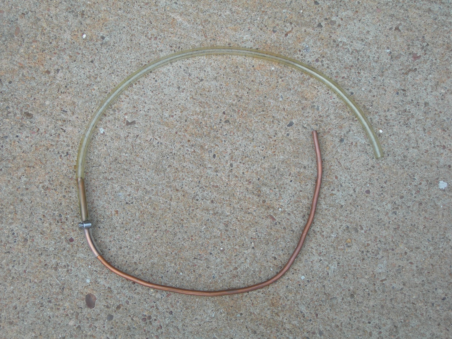

        Brief bullets - not step by step no guarantee expressed or implied but there are many threads I can point you to early (and some what not to do)
        get tranny fully hot (like after a real day out)
        forward, neutral, reverse, neutral and check the level and note if you like it or not
        get a suck up
        make a tube like shown or better yet with a fitting like shown
        pull the dipstick
        suck out 2.25 hot quarts (if not, figure that out or adjust based on the level you had)
        pour in what you sucked out but not more than 2 quarts because the new cold fluid is more dense.
        put the boat in the water, fire it up, forward, neutral, reverse, neutral and check the level cold. It may be a little low. If in range, run it until it is hot and check again.
        Note: ATF has a huge thermal expansion and your level is sensitive to heat. When the tranny is low, the lower end of the range is okay. After pulling 3 footers all day, the higher end of the range is expected. Avoid filling the tranny so full that when it gets hot, it overflows....not good.

          I left off the photos:
