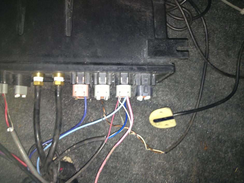

        Also... when reinstalling, I found a strange sensor or through hul sensor connection which is plugged into the gateway but is not physically connected to anything on the boat,it is just loose in the back ski locker. Can anyone help me identify it?

          It looks like your depth finder.

            looks like the air temp sensor, its the same sensor used for water temp as well.

              Air temp sensor seems correct.
